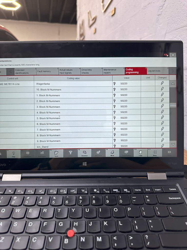

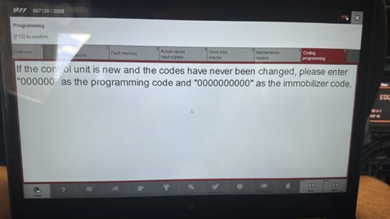

  7. It appears that in the DME programming the values for vehicle version and type were empty however when trying to set them in i get this prompt. Not sure what version to select. And on top of that the next screen is asking for old and new immobilizer codes so i didnt proceed since thats out of my scope

  10. None of the clusters were disconnected (as in no parts were replaced etc). All the errors were just thrown as soon as I connected the piwis. Im planning on doing a handover to see if that gets me anywhere. However, during one of the handover screens it asks me if the car is new where I always select no. Not sure if I should select yes as I havent been able to find resources on what happens then
