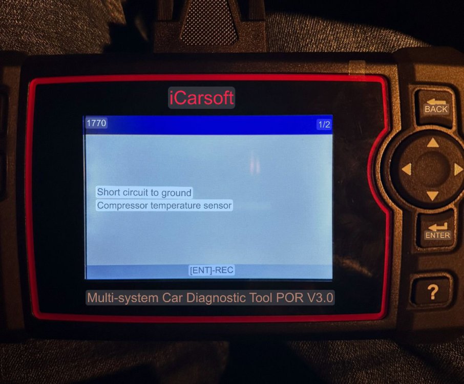

  4. So car is out of the workshop. They replaced valve block, everything worked perfectly during 120 kms distance, and after refueling, it popped up again chassis system failure, and after that warning chassis system, two fuses blown up again. Yesterday my icarsoft was registering data. Today car had no error, just a blown fuse after driving again, I’ve replaced it, and when I tried to scan with icarsoft, no data was available, and it’s not reading any data from PASM, but all other parameters (engine and so on) are readable. I’m really frustrated and I just want to throw up the car. Two months, more than 1,5K spent and 0 solutions. And as icarsoft is not working, I can’t check which parameters are wrong, but thanks for your help anyway!

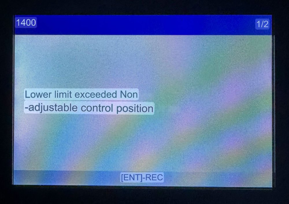

  5. I don’t know if this may help, but eventually between 5th and 9th of May, I got some errors that got cleared, and didn’t came back. Sorry for Google translation on image.
  6. Thanks Loren! I’ll give a try! And I will also speak with the guy at the workshop. Btw, I was considering purchasing a workshop manual for repairs, I’ve seen couple of webpages where they sell them, but there are many options even for same model year, and I was in doubt. Any recommendations? Would like to have it handy for any problem that may arise in future. I’ll let you know Loren! thanks thanks thanks!
