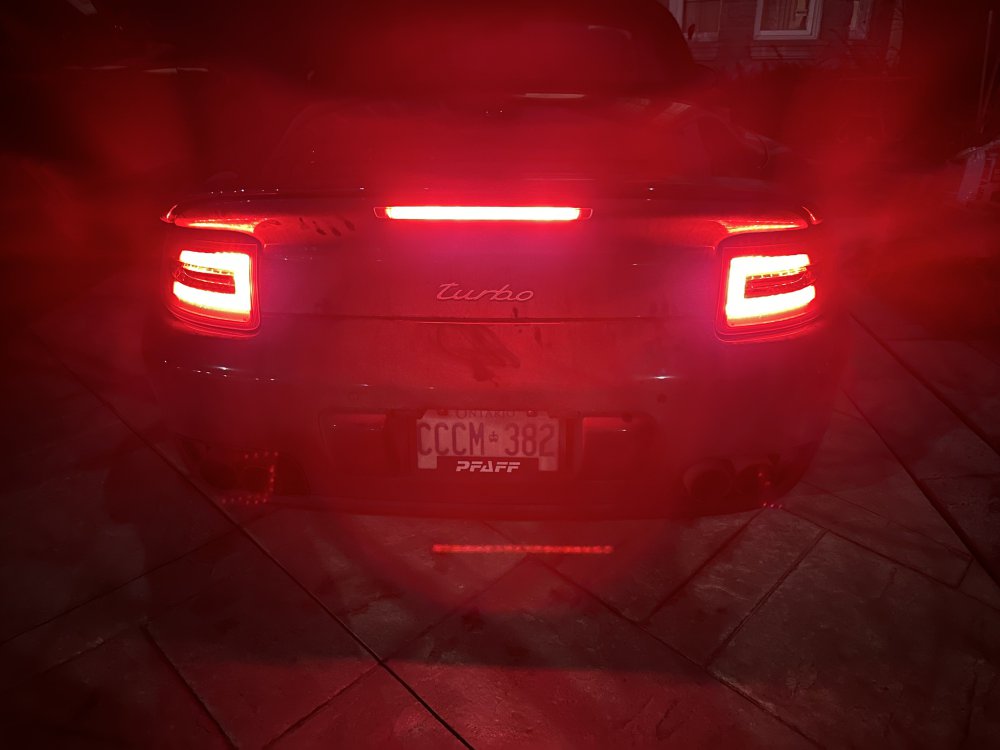

  1. looks like there is a short in the board. There is constant power on the brake trigger input in the box. I am wondering if that can also be software issue. Is there a way to do factory reset on the rear module firmware? Steve
  2. Thanks for your help Loren, it's the control unit. I replaced it and problem is fixed.

  4. It's the stop light that's staying on all the time. I change the stop light switch by the brake pedal, that didn't fix it.

  6. Hi, I am having trouble with my brake tail stop light staying on all the time. Looking at the schematic, looks like the fuse C F4 is feeding the CU PSM and it's re-feeding the A6 Stop light switch. Is my PSM box broken? Can I put a diode so that it doesn't back feed the power Thanks
