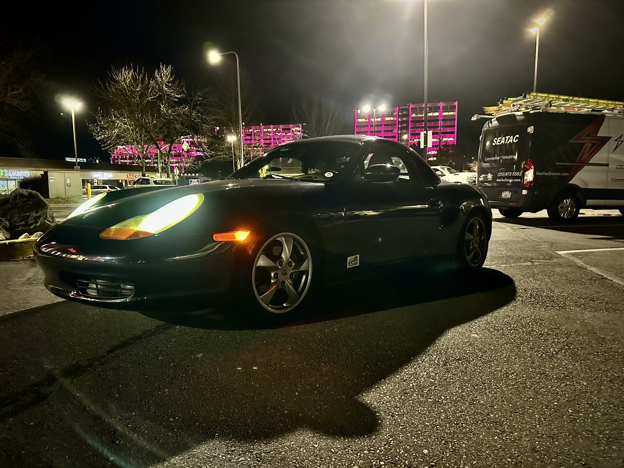

Hey everyone, I’ve got a 2002 Porsche Boxster 986 2.7L Tiptronic and I’m considering swapping out the two front wheels. Currently, I’m running; - OEM 17x7 front wheels - Part #: 98636212401 - OEM 17x8.5 rears: 98636212606 However, I recently picked up a clean pair of 99636212400 wheels, also 17x7 and 5x130, but from a 911, different design and style for the front. My question is: Will running these 996 fronts with the original 986 rears affect the car’s resale value, or be considered a negative? The specs are essentially the same for the front (size, offset, bolt pattern), but I’d like everyone's take on whether the aesthetic mismatch or originality concerns would hurt its value. I plan to keep the original 986 front wheels, so I can always include them if I sell later on if needed. Appreciate any feedback and especially from anyone who’s done something similar! Images:
