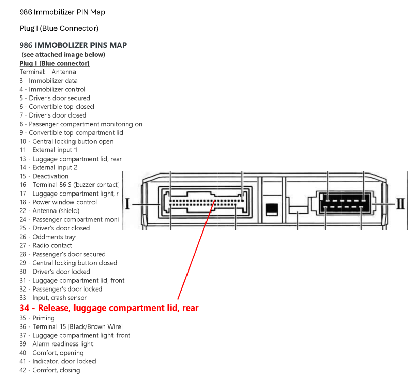

  1. Ran the scans and it's the immobilizer, so we have that figured out. Found a resource on here that can rebuild it and just need to send them the immobilizer and ECU. Bad news is that my independent shop forgot the ECU part of the job and now can't get into the trunk with the immobilizer removed. Not looking to start taking things apart to get to the manual release, but we can put power to the correct pin for the trunk release. Does anyone know the correct pin for the trunk release for a M535 996.618.262.03 immobilizer unit? I think it's #34 but not sure. 986 Immobilizer PIN Map.pdf
