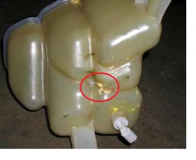

  10. You will have to remove the tank to repair it, and there will be no guarantee that using an epoxy weld or similar will hold up for any duration. With the time you will invest to "hopefully" seal it, you might get a leak very soon after it is pressurized. Since you can get a tank for under $300, I would just replace it with new. Before I replaced mine, I was thinking of trying to repair mine as well. Every shop I talked with essentially talked me out of it.
  11. Mine was almost in the center bottom - it will vary. I found a picture online that appeared to have a leak near the same area as mine. I have circled it. I had a hard time finding the leak also and it only did on heavy pressure. If you can feel around, you should eventually find residue solidified around the area. I never pinpointed it until it was removed. PITA to replace, but in my opinion, worth a DIY :-\
