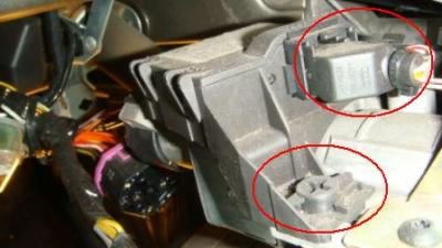

  1. I’m hoping someone has an idea. I’ve hit a snag on loosening the Phillips head screw with little wings that allows removal of the Immobilizer. It won’t turn to save my life! Any ideas on ways to loosen it? I have tried various screw drivers, prying it, it wont turn or move at all. borrowed a screenshot but that little screw circled in red is the one that won’t budge update! PB Blaster is a miracle worker for those right screws. I ended up needing it on a few screws. Thanks to everyone for the instructions! I also removed the dash and believe that helped to make it easier.
