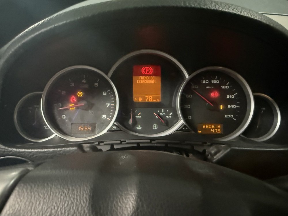

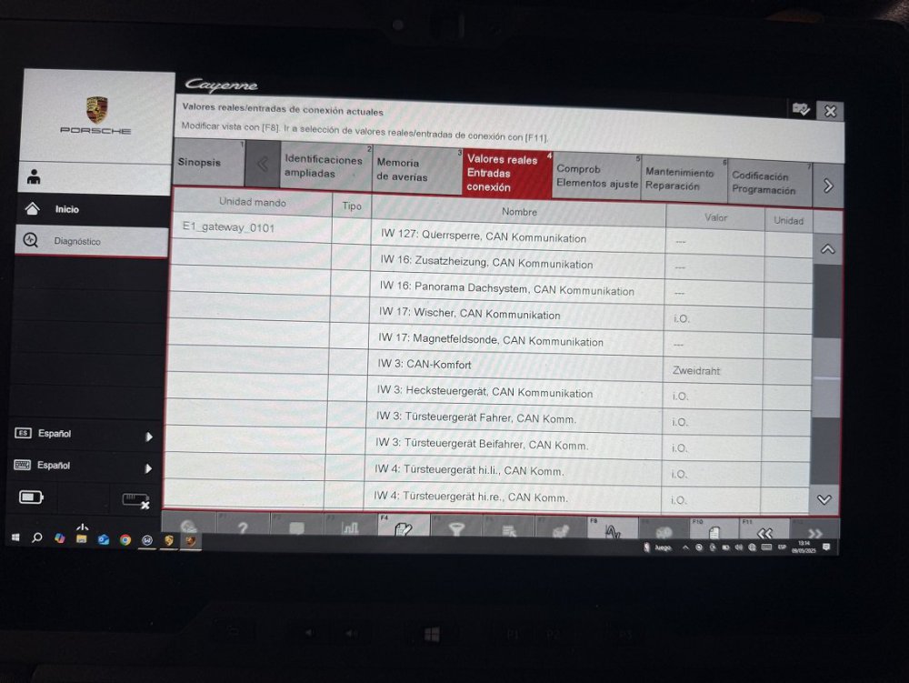

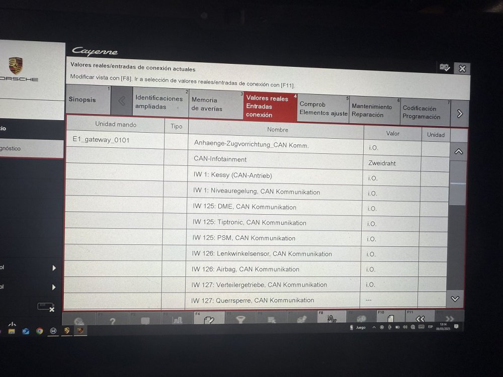

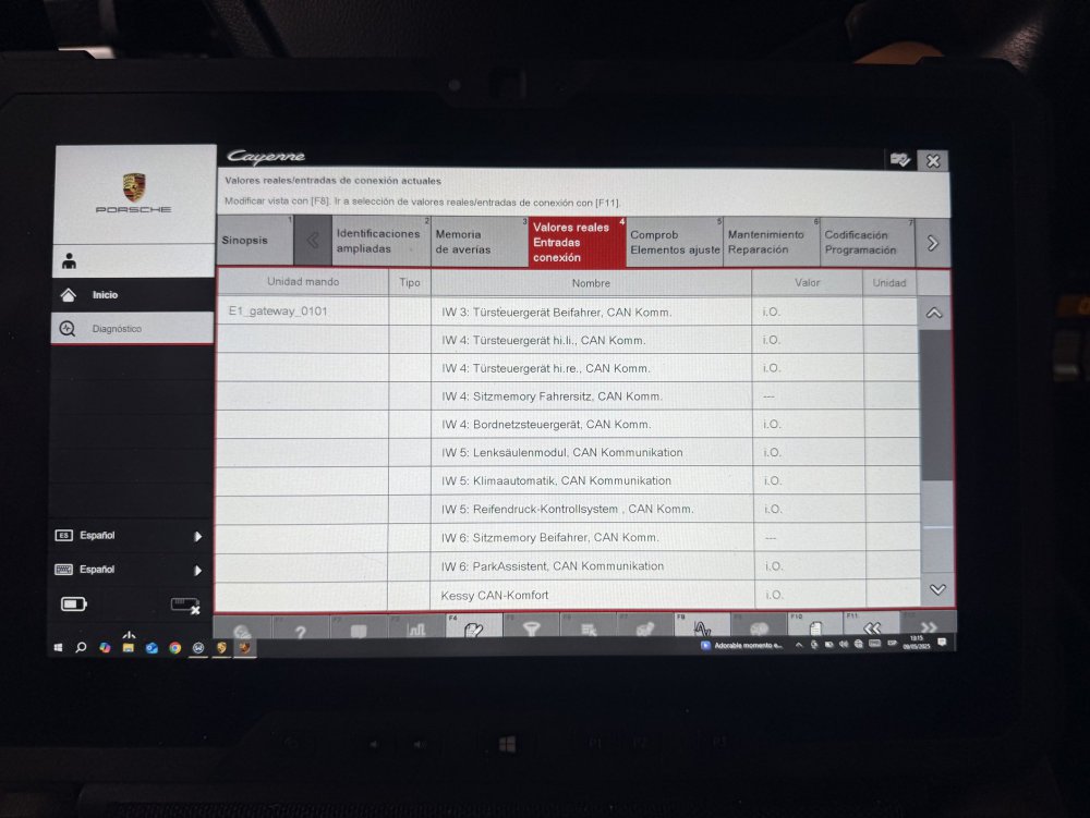

  2. The only thing I can think of is that the part numbers for the US and Europe are different, because the only instrument clusters I can find are with my part number. I was checking something on the car using PIWIS, and when I looked into the Gateway CAN module, I found something strange. As far as I know, in my car the gateway is integrated in the instrument cluster, but I’m not sure if that’s for the CAN, the comfort system, or both. The thing is, all modules show as “OK” except for the Infotainment CAN (I don’t have a radio at the moment) and the Comfort CAN. That last one confuses me, because I’m not sure if it’s supposed to be integrated in the cluster or not. I think it is. The weirdest part is that, while I was doing these checks — engine off, handbrake on, gear lever in P — the speedometer needle suddenly started rising, and I got several alerts about the handbrake being on and the hood being open. In my car, is the Comfort CAN supposed to be handled by the instrument cluster? Also, what exactly is the “rear convenience system”?

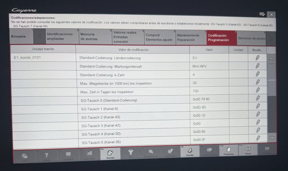

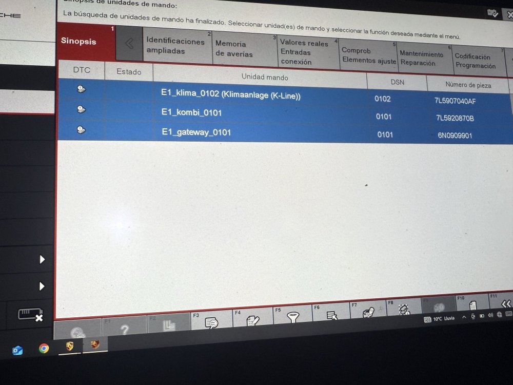

  3. Thanks again. In my previous message I wrote the part number incorrectly. The correct one is: 7L5920870B. I checked the label on the cluster (photo attached), but I don’t see any of the numbers you mentioned. I looked up your part numbers on Google, and on some used parts websites they claim they’re compatible with mine, but honestly, I’m not sure if that’s accurate. Several of those pages list both references (yours and mine) for the same cluster, and the label on those units also shows RB4, just like mine. Do you think it will be possible to program this cluster?

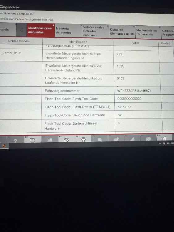

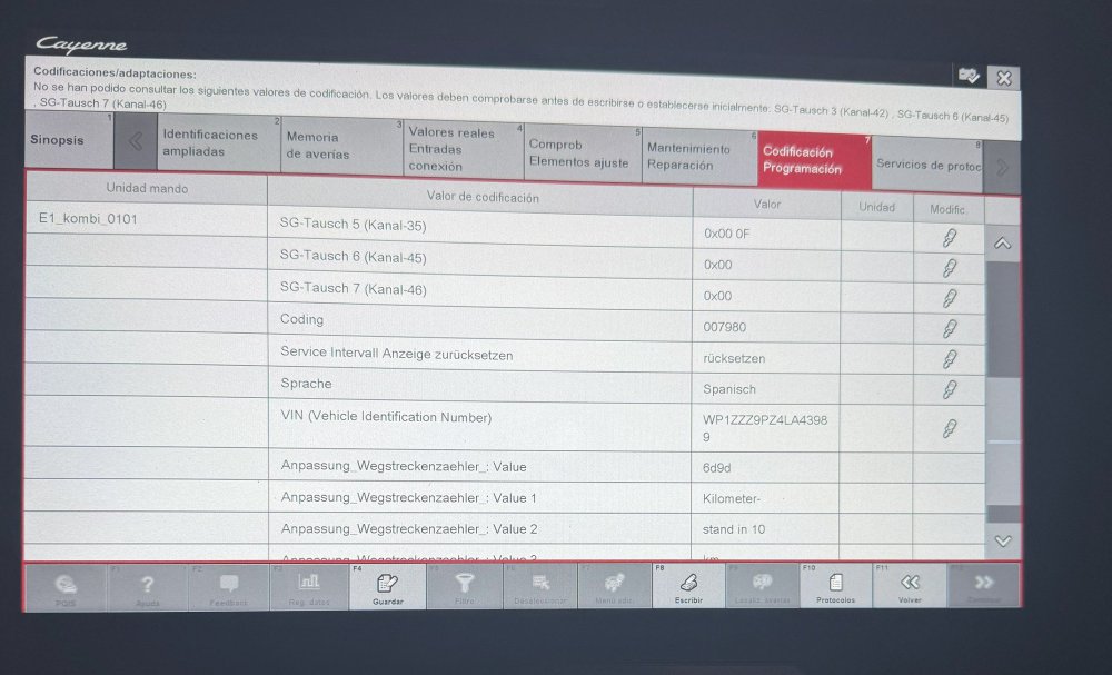

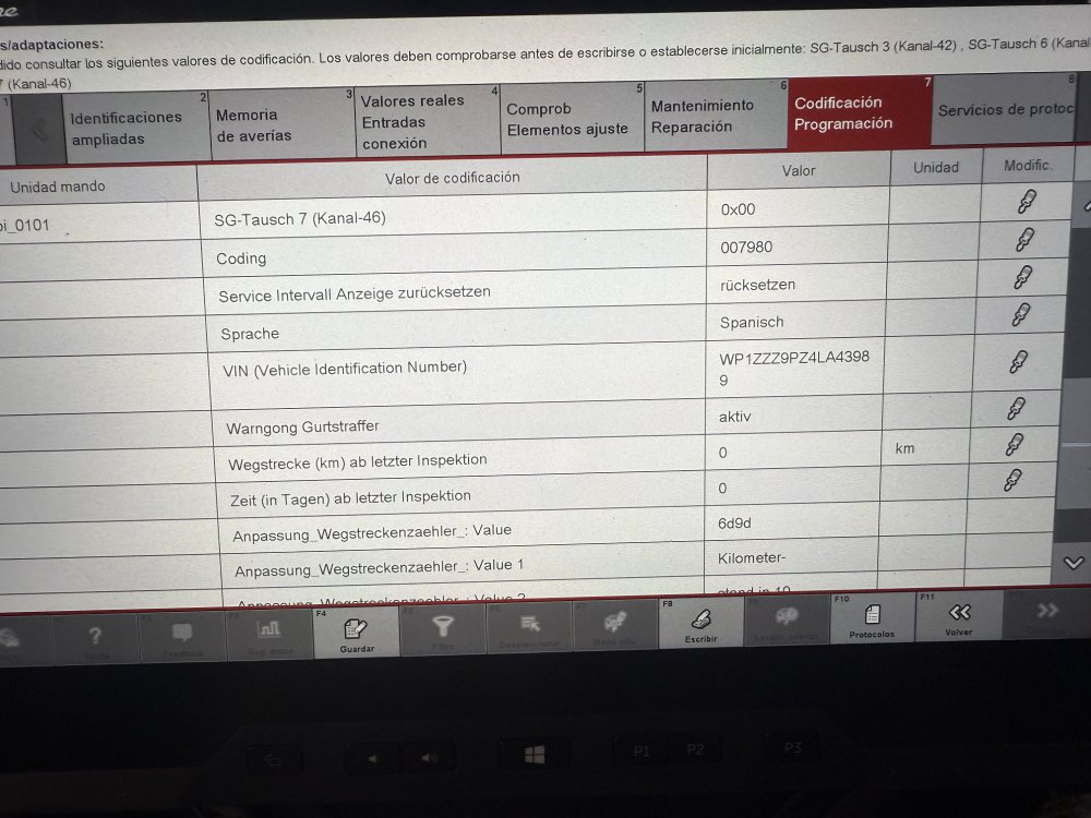

  4. Thanks so much for your answer. I'm sorry, but I don't know which instrument cluster the car originally had. It was abandoned when I bought it, and I'm restoring it now, so I don't have much information about its previous history. I do know that the cluster was replaced at some point, because the VIN stored in it is different from the vehicle's actual VIN. My car's VIN name is: WP1ZZZ9PZ4LA43989 The VIN stored in the configuration when I bought the car was: WP1ZZZ9PZ4LA46674 Instrument Cluster part numer is: 7L592870B (RB4):
