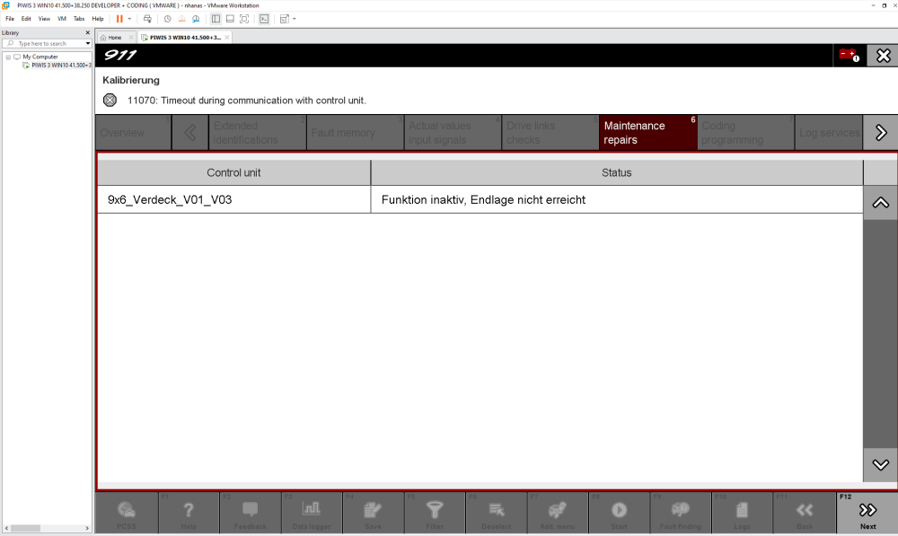

  1. I had both my hydraulic rams revised because one of them was leaking. Top works like it should now but clamshell and side flaps not working. Clamshell only with the tool. I got myself the VAS 6154 and PIWIS III. When i try to run calibration it is starting to lower the windows for a second and then trowing the error Funktion inaktiv. Endlage nicht erreicht. Any idea why it would not complete the run?
