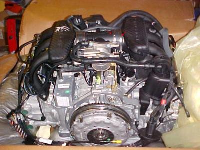

  12. heres a quick pic of the parts (fasteners) that were loose (circled in red, actually they on the other side, but still hehe) i hope the pic shows up, i usually use tinypic but im at work and cant so i uploaded it
  13. i opened the cover to unplug the MAF and noticed that those clamps on rubber boots were reallllly loose on one side, tightened them up and it runs much better. seems to be a bit of vacum leak i only drove it for alittle bit and it seems to be much better. will report tomorrow after a drive to work. BTW, when i unplug the MAF, the car jsut shuts right off....
