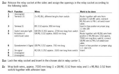

  1. Thanks! I got it going! It was personally WELL worth the effort . My relay pins and wires ended up as follows: pin1 - gray/pink pin2 - brown pin3 - none pin4 - red/gray pin5 - gray/green pin6 - red/blue pin7 - none pin8 - gray/red pin9 - none
  2. Hey guys I have the wires and switch all mounted for the system but it doesn't work. I followed those directions in that pdf that was posted for which I have attached an image. I think they may be wrong or maybe I'm not doing something right. the harness for the relay came with 2 wires pre-attached and since they didn't match up with what was in the instructions (and I bought the set second hand on eBay) I assumed they were wrong and didn't mark down which went where before I disconnected them. Can anyone please draw out a diagram with the pins and their wire colors for ALL the wires? Or even a pic of the relay hooked up will help. tia -Damian
