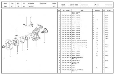

  4. The part number does not match any of the PET ?! It's manufactured by Brembo, there's the brembo part # 28.7181.01 visible on the picture, maybe you can ask a brembo dealer to lookup the part # ? Attached is the PET part number list for the wheel carrier(s) Hope this helps

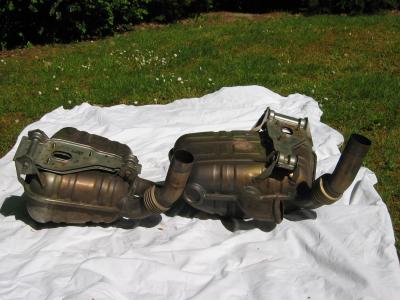

  5. If this can help, here's a pict of my 3.6 ones (removed from MY2004 3.6)
