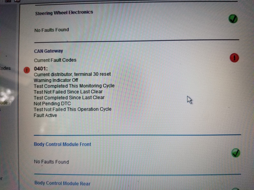

  5. Anyone know a site that can read durametric Codes? My 991 has pulled the PSM /Auto Start/Stop function not working dash warning and runs like crap and durametric codes are not in any of my books or online searches? Thanks much! Engine Module, C0600 No Signal Can Gateway, 0401 Terminal 30 reset PSM/ABS, 28688 / 7010 Warning Indicator Off 28672 / 7000 Warning Indicator Off Body Control Module Front 8784651 / 860b0b Electr. Ignition switch 6 Open Circuit
  6. Reply from Durametic Good Morning, Thank you for writing. All fault codes displayed within the Durametric Software are defined by Porsche. Unfortunately, we do not have any further information regarding the cause of the fault. You may want to contact Porsche for further troubleshooting. Please let us know if you have any further questions. Regards, Kevin Lewis Durametric Software Inc 888-854-5523

  8. I hooked up My 2012 991 C2 PDK to the durametic and pulled this Code Can Gateway Code 0401? Does anyone know what this is? Only Problem is my AC stop blowing cold. thx.
