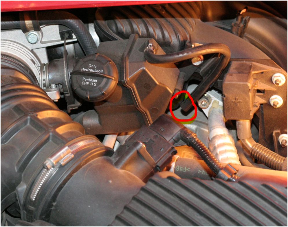

  12. :D Thanks.. Last night after reading so many postings on vac tube problems, I just had to make sure everything was still there. I should've known beter. Thanks much.
  13. Hi, I just found there is a tube that is open ened and wanted to make sure that's how it is supposed to be. If not, can someone please tell me where this is supposed to be conneced to? Thanks in advance!
