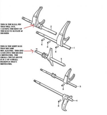

  3. FINALLY FIGURED OUT WHAT HAPPENED...sorry if this is too long (will be assembling tomorrow)! alright, so i started picking up all of the loose pieces and figured out what happend. the roll pin i found on the "trash magnet" fell out of the 3rd/4th gear shift rod/fork (not sure why that happened...maybe excessive heat from when my old engine broke a few valves, and made my exhaust glow cherry red). this caused the shift rod/fork to spin (a little less than 45 degrees) causing the front-back/side-side shift rod to become misaligned. the front-back/side-side shift rod sits inside of a recess (that's rotated by the side/side shift lever). when the rod became misaligned, it came out of the recess (reason why i couldn't reach 5/6th gear...didn't have proper travel). it also has four little bearings on the end that goes into the recess...2 of those also fell off and were on the side of the trash magnet). the bearing that i found in the back of the transmission, was not the needle bearing (shop manual wasn't specific enough for the 6-speed tranny...had to use autoatlanta.com's exploded parts diagrams), it's called a cylindrical-roller bearing. it was an absolute PAIN to get the shift rods out of the transmission (needed to remove to replace the 4 small bearings) with all of the gears attached. there's a plate that all of the shift rods "ride" on, and it's held on with 2 T40 bolts. the bottom bolt...easy...the top bolt is almost completely blocked by the 3rd/4th gear shift fork...had to use an offset screwdriver (with t40 bit in it). basically, i'm going to replace ALL roll pins, 4 small bearings on shift rod, and have a tech at the dealer inspect the rod and make sure it's still "true." description of pics: 1 - trash magnet with roll pin stuck to it 2 - 1 of 4 small bearings that go onto the shift rod 3 - kinda bad shot of what all rods looked like with cover removed 4 - a description using an exploded parts view of all shift rods

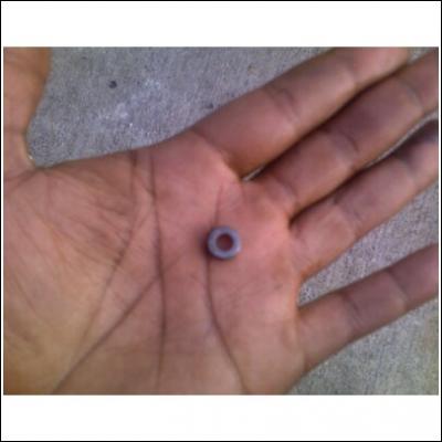

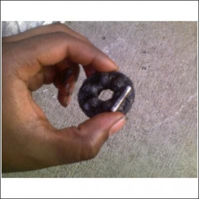

  4. alright, so i went ahead and removed the gearbox cover and found a few interesting issues: (pics will be included momentarily) - the side-side shift rod is supposed to sit in a "socket" well, it was resting outside of the socket (see pic) - when i pulled off the cover, the input shaft needle roller bearing was sitting in the bottom of the cover. the manual says that this bearing should be pressed in...so i'm assuming it worked it's way out...maybe go over-heated when i had my last motor issue. (see pic) - this is the only part i'm not sure off...there was a roll pin sitting on the "trash magnet" in the bottom of the tranny. i'm trying to figure out what it fell out of. i'd like to get a few suggestions on putting the cover back on (should i replace anything else...sync rings, etc.). everything else actually looks good.
