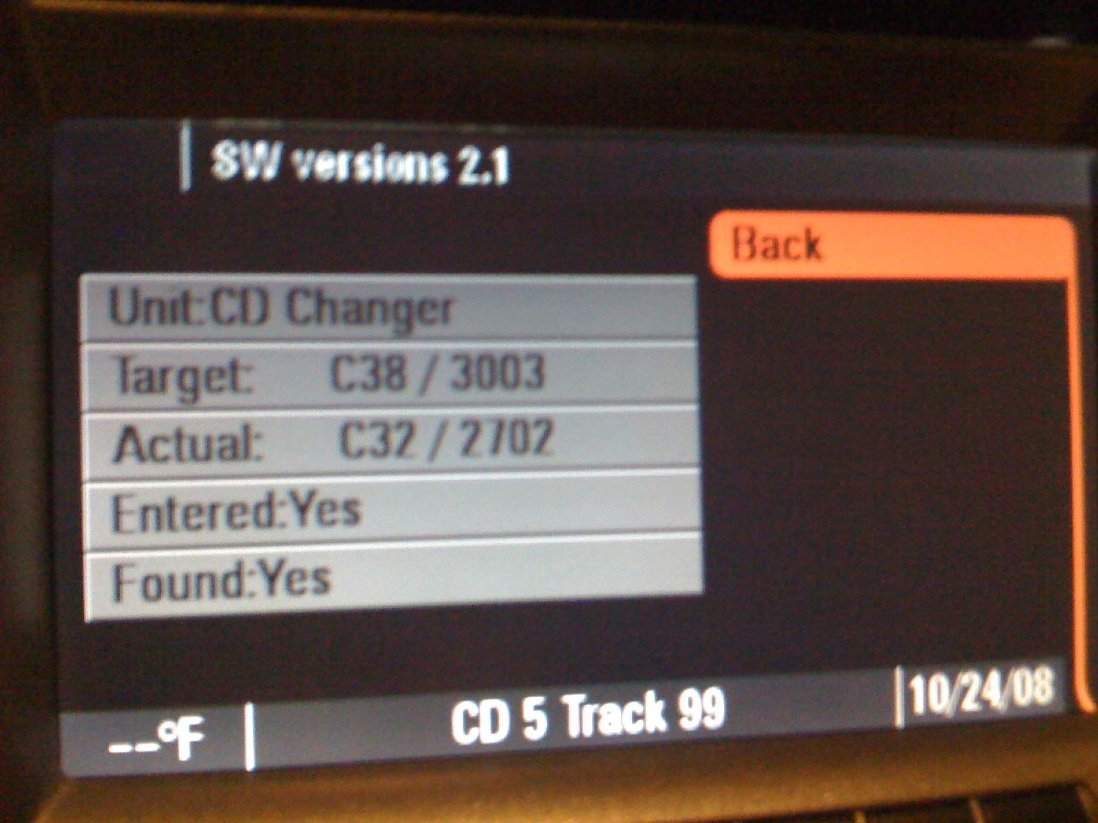

  8. Strange. I have have nothing in target, only actual. I notice that your PCM says version 2.1. This is an old software version so there could be an incompatability with the Dension? You should be able to get the PCM up to version 3.0 (the dealer will have to do this for you). I think you must have everything in the right order because it is all listed there. If you have upgraded your Dension try rebooting it (pull power out and plug back in). Go into the config mode and check the the options are correct for the PCM. I can't remember off the top of my head but the recommended options for PCM are listed in the install guide. Are the DIP switches on the Dension in the right place (you did change them)? Also when you are on CD 6, use the right knob on the PCM and select track list. Let us know what you see in there - you should see IPod GW. Is music actually playing from the IPod at the moment, just that you don't get the track names (just checking!!) :) I might have to upgrade the PCM yeah... Hopefully thats not a costly process <_< The dip switch settings are correct they are configured for PCM with no Cd Changer which is my setup. Yeah, the music plays from the iPod just I can't seem to pull names... At no point of operating the Dension have i've seen a screen saying IPod GW, AUX.... Whenever I go to CD 6 I Don't see IPod GW, no form of text at all... Even in config mode it doesn't say config on the screen. Apparenly it's supposed to somehow show what firmware you are using too on your ipod or on the main screen? Yeah, haven't seen that either...

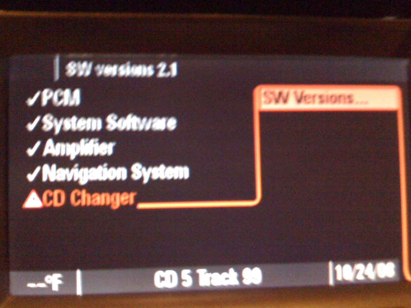

  10. Here are my results from the MAIN and TRIP buttons... It seems weird the target and actual are pointing to different places?
  11. Here are my results from the MAIN and TRIP buttons... It seems weird the target and actual are pointing to different places?
  12. So if I push MAIN and TRIP and don't see CD, I'm out of luck as far as track names? Or is that just to check if the dealer has enabled it? Also if the devices aren't connected in the right order would the Dension still work? I'm wondering if that has anything to do with it because mine still works but I'm not sure what order it was done in. Another thing that gets me is the fact that my setup works no matter what the dip switches are set to... Something is definitely wrong :(
