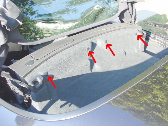

  14. Thanks, but that wasnt it. The lid was the first thing I checked. I guess the next question is... If it is trully a control error, the how can I manually get into the back to check the control unit with the top in the down position?

  18. I'm looking for the part number and correct name for these 997S CAB Plastic Plugs located under the CAB clam. Porsche just sent me the wrong ones
