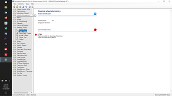

  5. While checking another issue I checked all systems for error codes and found Error Code 1749- Tiptronic switch on steering wheel down under Steering Wheel Electronics using Durametric Software. Steering wheel shift switches are working fine. I've tried to erase the code to see if it comes back, but it doesn't erase. I have researched it and don’t seem to find anyone that has posted about this error code. Anyone seen this issue/error code before or have any recommendations? Thanks in advance for any recommendations.
