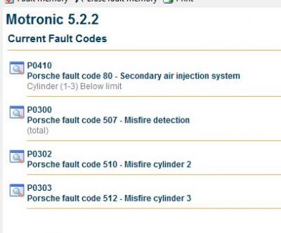

  2. Here are the codes it showed this time. Misfire and now a secondary air intake.

  4. Have you checked the timing? Can you tell if you are getting back pressure into the intake? We had one that was off a few teeth on the camshaft -- it would turn over -- but it was not happy and would not idle. m Not sure on how to check the intake - Hints? I hooked it up to the Durametric tool again this morning and now I am getting P0300, P03001, P03003. Misfire issues - Would this be a condition of the MAF sensor? Some of these posts indicate a coil issue.
