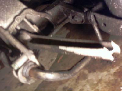

  4. The old part is a track rod but has been superseded by "AS STEERING TIE ROD" 997-331-045-04 per the retail price list on Renntech $171 Rick 99 996C4 87 944S Thanks for your reply Rick. Have a Merry Christmas

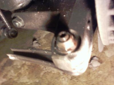

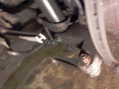

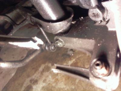

  5. Well, first snow resulted in what I believe is a broken rear lower control arm, not really sure. Almost home and rear end slid out and hit the curb. Looked at the body, no damage but the wheel looked cocked in on one side. Got home, took the wheel off and look what I found. Could someone please tell me the correct name of this part? Doesn't look to hard to switch out. car is 00 C4.
  6. First on my list to do for tomorrow. Just hope and pray I don't have a flat in the meantime. thanks

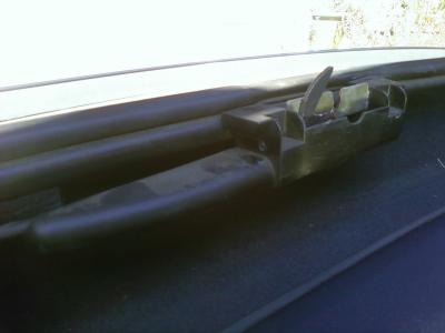

  9. The part I need is the plastic flap that protects the convertible top from snagging when the top is being opened. I also need the part that the flap attaches to because one of the tabs is broken off. 00 C4
