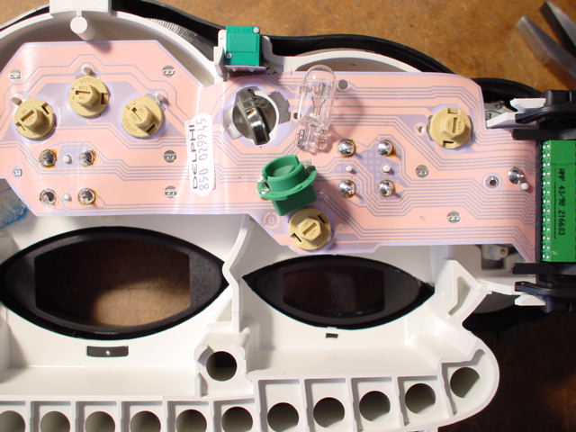

  1. I'm a little confused as to how many bulb there are per LCD display. I see it mentioned that there is one per LCD display (total of 3), but the pictures indicate there could be more. Without having opened-up and instrument cluster, its hard to determine exactly how many bulbs there are. This picture looks like there is only one per LCD display: But in this picture there appears to be 3 bulbs just for the center LCD display:
  2. Any writeups on how to change "all" of the LEDS (IC, A/C, Windows, etc) from amber to something else? I haven't really seen anything other than people saying "it's going to be difficult... you need to solder stuff... etc" just curious I've been browsing this subject and I did not see any comments indicating that soldering was required. Not sure about changing the color. I would assume the bulb is clear (at least it looks clear) and the color (amber on my 986) is from the plastic covering on the instrument cluster.
  3. Thanks much. I printed-out several of the threads here on RennTech on this subject. I think it's something I can tackle. I'm sure the service dept. won't even think about opening-up the instrument cluster and replacing a single bulb. Do you recommend replacing all 3 bulbs since when the instrument cluster is out and opened?
  4. Thanks. I mentioned replacing the bulb to the Porsche service department, and they acted like they never heard of such a thing (they suggested replacing the entire instrument cluster). Any ideas as to why the bulb would be intermittent. The display has not been illuminated three different times now after I start the car (in a timeframe of 24 hours). If I hit the top of the dash with my fist, the LCD becomes illuminated. Appears as if it might be a loose connection rather than a bad bulb?
  5. Thanks. I spoke to the Porsche service department again this morning, and they stated that they did not know anything about just replacing a bulb to fix this problem (but then again why should they when they can charge me 100's of $$ to instead of replacing a $10 bulb).
  6. I am having a similar problem where the SPEED and TEMPERATURE LCD display is very faint. If I hit the top of the dash with my fist, the display will come back to normal intensity. Is there a single bulb that is used to illuminate this part of the LCD display? ps. Dealer suggested I need a whole new instrument cluster. Thanks.
  7. Let me clarify, this is the speed and temperature LCD display on the bottom of the tackometer gauge. This is NOT the row of status lights below the three instrument gauges. I would be surpirsed if the LCD display could be controlled by a single bulb.
  8. The digital readout on the center gauge of my '99 Boxster was not illuminated (rather it was very faint). Took it to the dealer, he banged on the top of the cluster with his fist, and it started working again. He told me that this is a common problem with Porsches were the LCD "wears out" and that I would eventually need a whole new instrument cluster. After reading some posting here, it sounds like individual bulbs can be replaced to solve my problem. Is this true because bulbs will be a heck of lot cheaper than the whole instrument cluster. Thanks.

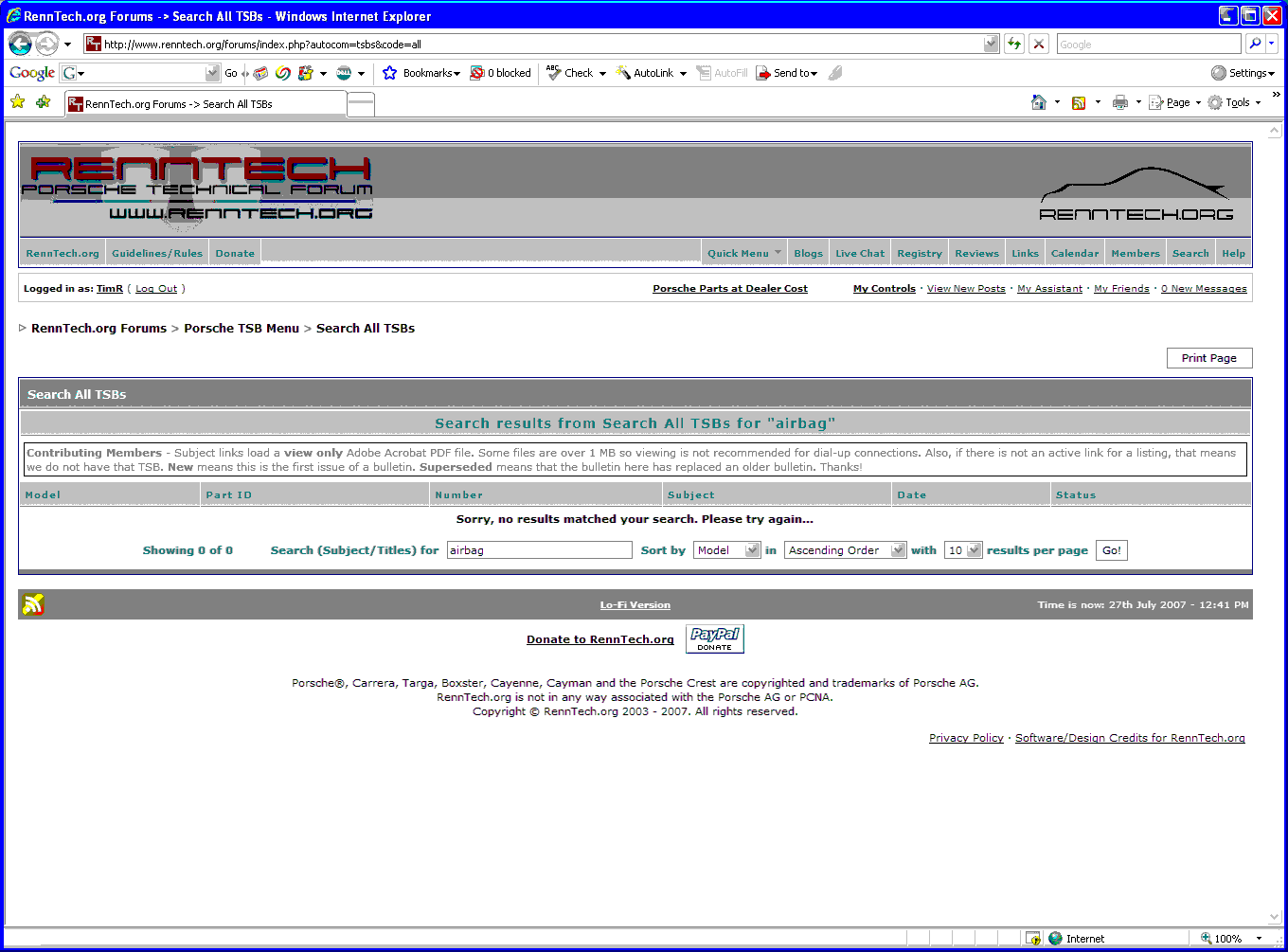

  13. Is there a restriction on printing the TSBs? I was unable to print a TSB. Is that normal for the RennTech site? If so, is there another site that will allow me to print the TSBs?

  16. Thanks. I am not sure what I am doing wrong, but I still can not find any TSBs. I go to "Quick Menu" and select "Current TSBs". Then I select "Search all TSBs", then enter "Airbag" as the subject or title, and press GO. It echoe's back "no TSBs found". It worked for me yesterday.
