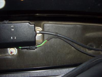

  1. Sorry to keep being so difficult! I read the article about replacing the cables with the newer reinforced ones. After reading it I went out to my car and checked and they actually do have the texture of the reinforced ones, like the diamond pattern. That being said, could it still be a cable problem? I just don't want to try and take it somewhere to get looked at because I ALWAYS get ripped off!! :soapbox:

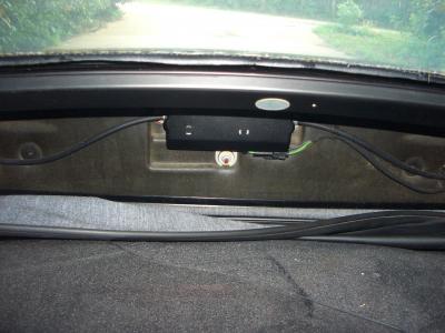

  2. Thank you guys for your help, I really appreciate the info so far. It was really frustrating me today so I went and took off the vinyl cover to reveal where the noise was coming from. I'm assuming that the black box in the first picture is the motor for the top? Well when I push the "open" button to put the top down, the cables coming out of the driver side of the box (the one where the green line is attached) move up and down and that is where the ticking is coming from. The single cable coming out of the passenger side doesnt seem to make any noise or movement. I tried moving the cables around to where ever they attach at the motor and they move around a bit but still nothing worked. Sooo - I guess I will try and do the cable thing myself, if that's what everyone thinks it is after this post. Thanks again for any info you may have!
