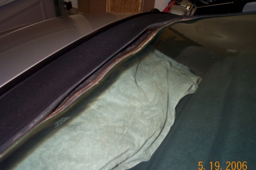

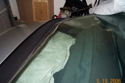

  7. I just had a problem with my 1999 996 Cab top. The rear window began to delaminate from the canvas top. It looks like it was glued or welded together originally. The window is now sagging and it obviously looks very bad. I attached some pics. My questions are: 1) Has anyone had this happen and what did you do? 2) Can anyone you all know repair this? (CA central valley or bay area) 3) What type of cost should I expect to repair this? Thanks for any ideas / help. Dan Here are the pics:
