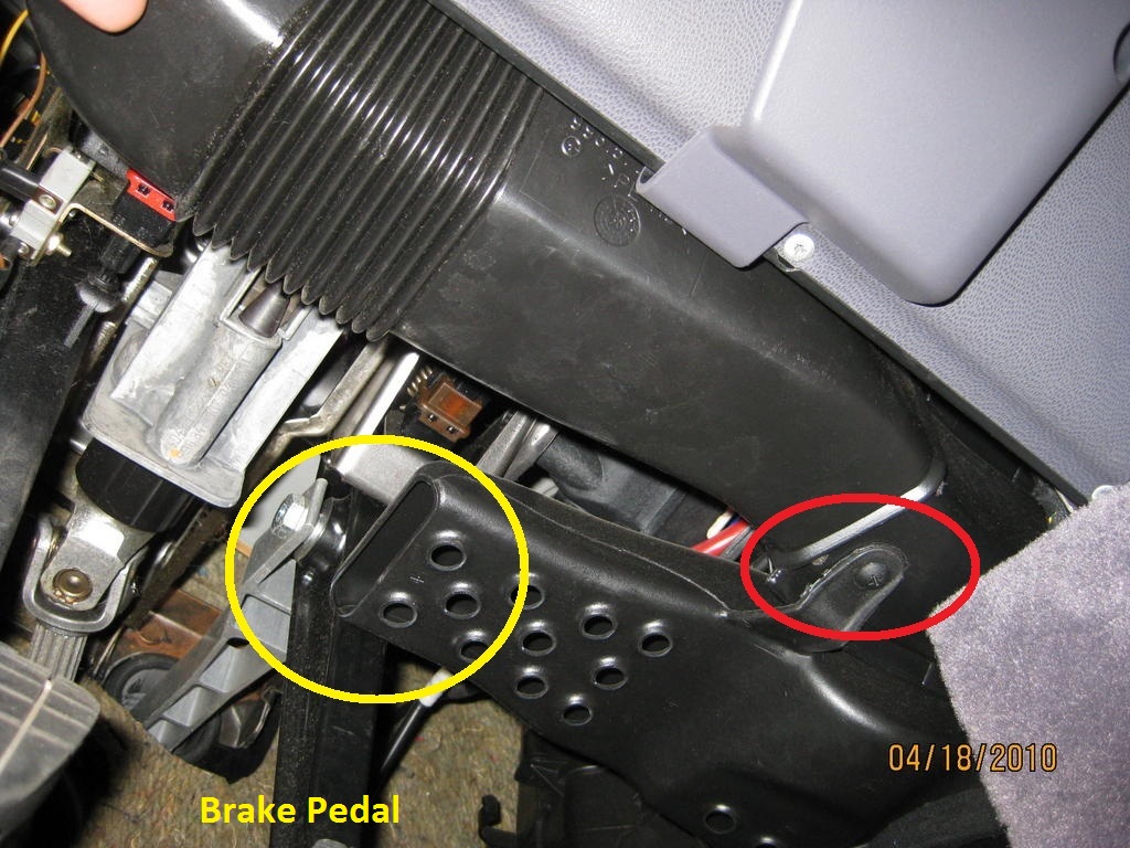

  3. How to remove this first piece of heating duct (w/many holes) near the brake pedal? (Photo attached). I've removed the first screw (red circle), but something else is holding it in (more screws or attachments). Please advise how I can remove this piece of duct. Thanks. The reason I need to remove it is that it's blocking the brake pedal from returning fully to its starting position (by a few millimeters). Footnote: The photo markups are mine, but the base photo I borrowed from another post, because it was so clear.
