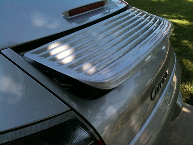

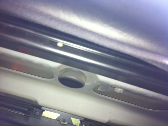

  11. I haven't had a chance to attach the Durametric yet but I have new info While working on an unrelated roof rattle and roof hook refusing to latch issue. (sigh). The failure lights began to flash. While this was happening the car was cycling the rear wing! Any ideas? I will attach the Durametric when I get the power suppy for my pc found!
