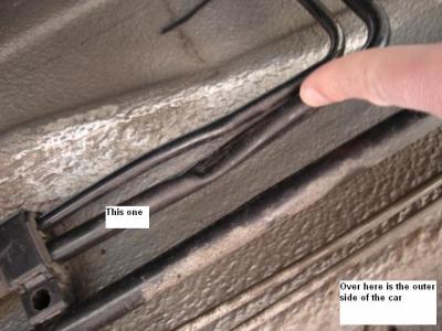

  10. Do you think I can cut the pipe and replace the cruched area with another pipe? Rather than buy the whole return line so to speak? What type of piping should I use, metal or fuel line type? Thanks Gareth
  11. Nice one fellas, Correct! I found out that the hose in question is the P/S return line, and though it's somewhat squashed, if there's NO leak or crack, it should be fine . . . Hard to beleive, but that's what a local Porsche dealership advised . . . What do you think? What are the possible problems I might encounter? Am I looking for trouble not replacing this line? Thanks INDEED for all the help! G
  12. CJ, Yes, it's on the driver side close to the edge of the car, correct, the first two thin lines are A/C lines, then there are three more larger ones, the middle being squashed in my case. I turned on the A/C, and felt the pipe, it didn't turn cold . . . It didn't get warm either really . . . So do you think it's the Power steering pressure line? We need some extra opinions on this perhaps . . Where's Loren when you need him . . . Thanks fellas. G
  13. Hi there, I have a squashed line underneath my 99' 996 C4 . . . Just can't for the life of me figure out what this line is for . . . One guy told me Fuel, the next told me power steering pressure line Part#99634745132 . . . I'm enclosing a picture for you pro's to see . . . FYI - It's located on the DRIVERS side, close to the outer edge of the car next to what I believe are 2 A/C lines . . . Any help would be super. Thanks G
