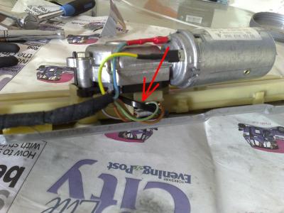

  3. Hi Guys, Finally I had chance to look closer to the issue with my rear spoiler. I have checked both relays and they were working well. Then I decided to take all the lifting mechanism off the car and to look for a dead mouse :P - and I found her B) Unfortunately I did not take any picture when I was getting the thing out from the car, but it was very easy and it was matter of couple of bolts and nuts on each side. When I pull it out I then looked right inside to find out how it is actually working. What I found were two switches (green arrow). I have checked them and they were working fine. Because the spoiler was moving just little bit up and then stopped I tried to do some working simulation and found out that the white rider (red arrow) was little bit bended. It meant that one of the switch got into off-state to early. I was scratching my head for a bit and then I picked the easiest solution: To get switches closer to the rider was easy using plastic stripe. I put it all back and it was working since then without any problem.......... :D :D :D GRIP IS BACK :D :D :D Hope this will help someone, Radim
