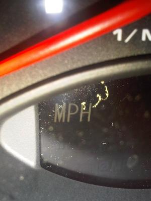

  8. Thanks for the info. The car has recently had a major service - I don't suppose this would affect the dashboard. Attached is a picture of the corrupted display. Danny
  9. Morning all. I wonder if anyone can help me with this. The dot matrix display of my 996 C4 1999 ROW has developed a fault. Where it displays MPH, there are a number of pixels that appear to be stuck on. I think the pattern changes slightly each time I switch on. If I were talking about a phone or computer, I'd say it looked like it had a virus. I recently had a major service. Has anyone seen this type or fault before? Danny
