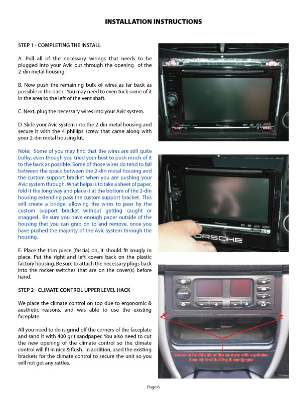

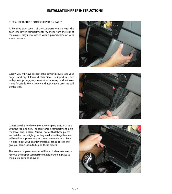

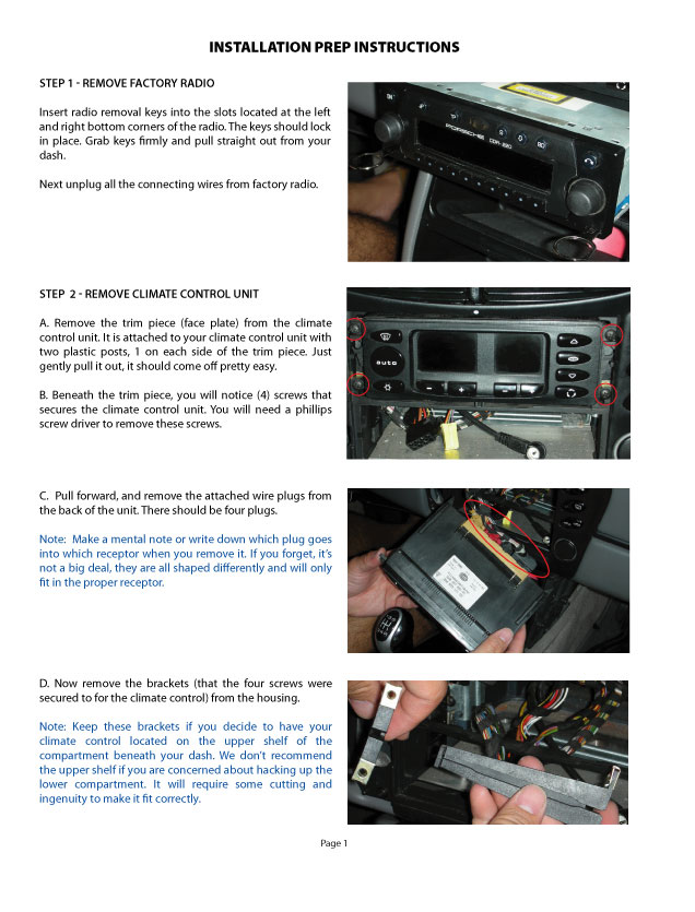

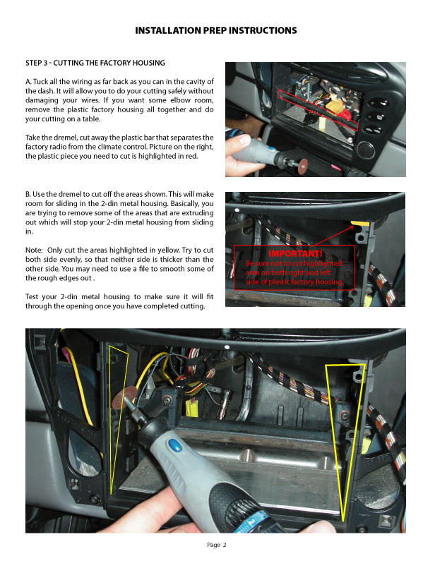

  3. Porsche Boxster Avic D3 Installation Instructions Instructions below: Author trieullionaire Category Boxster (986) - Accessories Submitted 04/15/2008 08:02 PM

  7. The climate control is actually designed to fit the lower of the two compartment (the compartment right above the bat wing). It slides in easy and is made to fit perfectly there, I was very tempted to go this route because all you need to do is bring the wires down and slide climate control right in and put on a trim piece. But yes, you can move the climate control to the same spot as in the picture. It requires some work though and might not be the easiest thing to do as you will need to modify the space to insert your climate control there. The outcome though is better ergonomics, its more accessible and completely visible since your gear lever shouldn't be in the way.
