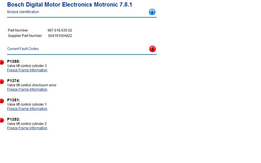

  9. I'm not sure of the specifics, other than there was visible damage of some of the cat element. Some of the early 06 Caymans had cat problems, and in fact, my original left sided cat had to be replaced about 2 years ago when it went bad. I think this one did throw a cat efficiency code on 1 or 2 occasions, but only after running at high rpms, and not consistently. In retrospect, my service adviser mentioned that if they have another car come in with a similar problem, the cats will probably be one of the first things they look at, rather than the last.
  10. It was pretty much by the process of elimination - after doing various things like switching sensors, coil packs, actuators, etc. from one side to the other, they had reached the point where they thought that it might come down to replacing the DME, or actually having to replace the whole engine (Porsche was apparently recommending that it might be necessary to replace the engine, rather than tear it down to look for a mechanical problem)! They finally decided to take a look at the cats directly by removing the headers, and that's when they noticed that the right side was partly bad. Replacing it cured the problem.
  11. **UPDATE** Problem solved - after 5 1/2 weeks in the dealer's service dept! It turns out that the problem was the right side primary cat was partially bad. It wasn't bad enough to cause a problem or throw a code under normal driving conditions, but under high load/flow (i.e. variocam range) it was apparently obstructing the exhaust flow enough to affect the valves on the right bank, and cause the lifter and misfire codes. Both headers/cats replaced under the 8 yr/80K mile Emissions Warranty - I am a happy camper again. :thumbup:

  13. I did - however it only seems to return under a combination of lateral g-load and high revs; cruising around town it is fine. I wondered if it might be due to faulty coil packs, so I replaced them all, along with new spark plugs. Even with that, I got a misfire code on cylinder 3 today when I tried to reproduce the condition on a freeway cloverleaf ramp. I'm off to the track tomorrow to see what happens. If it recurs, then I'll be taking it into the dealer on Monday to have them look at it.
  14. That sounds a bit ominous - I was hoping maybe it was just a faulty sensor or something. I hope this is covered under my (non-Porsche) extended warranty . . .
