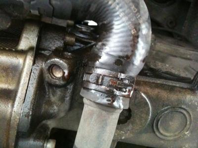

  3. Well guys here's an update on the progress: 1. the leak from the rear left side was indeed the Power Steering hose, (which was dripping onto the exhaust causing smoke as it evaporated but only when in reverse gear for some strange reason!) 2. the loud screech sound on start up was of course, the Starter Motor which is been replaced, (I'm buying a brand called LUCAS over the BOSCH because of cost, it's from Porsche specialist! you know what they say buy cheap buy twice but I'm sure it be ok in this case) 3. as for the CEL/ check engine light, we still can't find the cause of the code's: P0430 code 45-Cat conversion bank 2 P1411 code 208- Secondary air injection system Any suggestions for these codes would be gratefully appreciate, as we currently have the engine out now's the time to look and fix. Also given the car a general service, filter's & oil. I was going to use 5W 30 oil as some say it's better suited to the 996 than the 5W 40 don't want to cause a tread post war about oil I'm just curious if anyone has tried it? More importantly are the cause of these codes so if anyone thinks they know please post. Cheers will keep you's updated. James

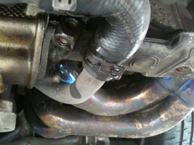

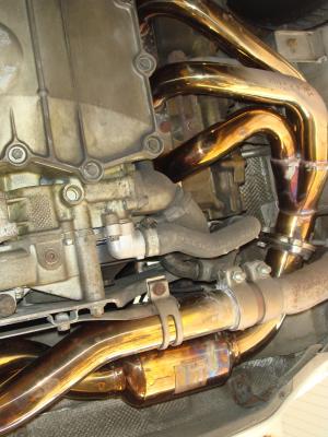

  6. Why is that odd? p.s. I just checked the coolant + tank and all is ok it's actually pretty full? here are 2 pictures, I've had a good look around and from what i can see from the bay area there seems to be a leak coming form the hose (R.H.S) I have in my hand a dripping down thru the engine?

  9. Forgot to mention the leak is on the right side of engine!
  10. it kind of feels like oil? No real smell at all but when it drips on the driveway it stain's like oil. I'm sorry I know it sounds like Im contradicting myself :)
  11. Pictures are all mixed up sorry:

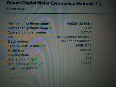

  13. Hi all Yet again in the world of Porsche ownership I have another new problem. It's a numbered list so please fell free to answer any or all if you think you can help. Like always I really appreciate everybody's help and many thanks in advance guys. 1.Today while driving my CHECK ENGINE light came on. 2.Smoking out of left exhaust and from general engine area? (white with burning smell) 3.Liquid dripping from under engine it's dark in colour don't thinks it's oil? see pic's 4.Coolant's ok level as is oil, no mayo substance in either coolant tank or oil filler cap 5.Loud screech sound on start up (see video attached maybe related to CEL?) Durametric results are:

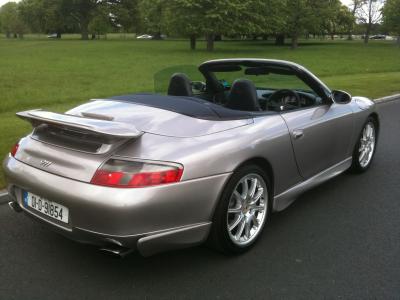

  19. Like once a year, I've even got caught in the rain with the roof down and driving fast does not stop you from getting wet :) I was thinking one day to get a Smart top control unit. Which opens and closes the roof while driving ahhh the luxury.
