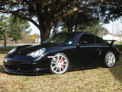

    Just joined this forum and wanted to say hello. I've found so much useful information already and just wanted to say thanks. I have an 05' GT3 and an 88' Carrera that I turbo charged a few years ago. Here are the obligatory pics. Thanks again.
