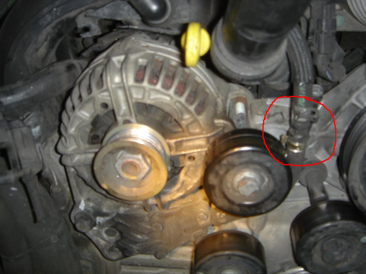

  2. Hey all, My alternator was dying so after doing some research around these forums, I decided to have it rebuilt myself instead of buying a new unit. I followed some of the write ups people have on here and had a hell of a time trying to get the thing out, but its out now. Unfortunately, in the process, I snapped something and it looked like part of a coolant line (from the green fluid that came out). Its not the black line above the alternator but actually a plastic line/hose connector type piece to the right of it. I've circled the piece in the picture here. The lines are fine, its just the plastic nipple part is broken off inside of it. My question is, do any of you know what this piece is, and can I order it separately? Also, since I lost the little bit of coolant (assuming it really is coolant) from the lines, should I do a coolant flush/refill when I replace that part? Thanks guys, I can get better pictures of the part later, I just borrowed a pic from someone elses write-up here.
