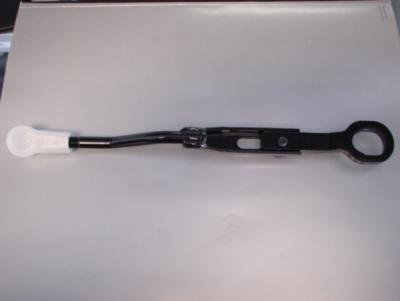

  1. I now have a clue. After reading all of the postings regarding tops I found out that what happened is that the plastic joints in the push arm broke. Are these easy to replace? I can only find instructions on how to take them out but nothing on putting them back on.
  2. my son inadvertently tried to open the top while it was not fully unlatched (oops!), there were two loud noises from the back compartment almost immediatly when it started to try to open, and that was it! now I hear the motor humming but nothing happens. Am I in for a big repair, or is it just something that I need to snap back on? thank you without a clue, jorge
