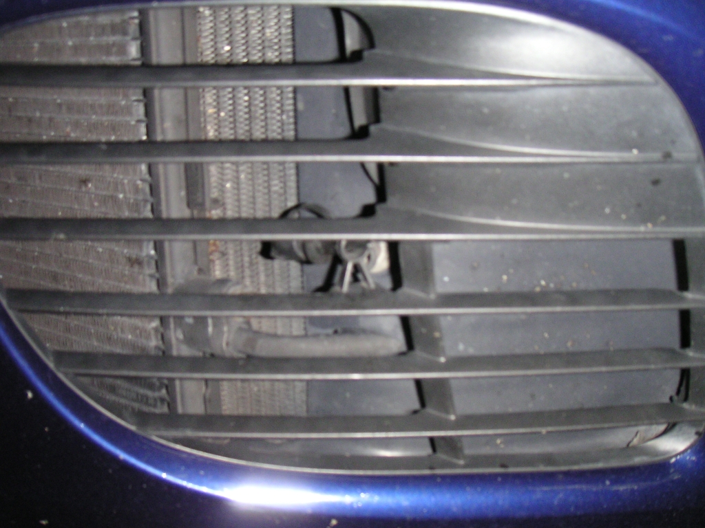

  4. Just an update, It has been two months since I had the low temperature issue and now after warmup it runs right between the 8 and zero no matter what the temperature is outside (over 100 in NY recently), with or without A/C, and I typically drive aggressively on the quiet roads on my way to work. So, hopefully this is an issue of the past. I vaccumed the front radiators and I think the Blue Monster is smoking behind my back, I am guessing 20 cigarette butts came out. I am getting the tech inspection in a couple of weeks for my first Driver's Ed in July. Thanks again. B)

  6. Thanks for the quick response. I looked at the intakes (left, center, right) and there are no major obstructions, but it looks like there are some small peebles and debris. I am not sure of the best way to remove these or if they matter (see photo). I uploaded a photo of the right front intake and it has a plastic cap (unconnected) and a small opening that it looks like the cap it fits into. I couldn't find anything in the manual on this, could this be the culprit? Thanks again.
