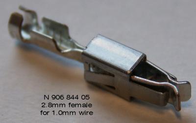

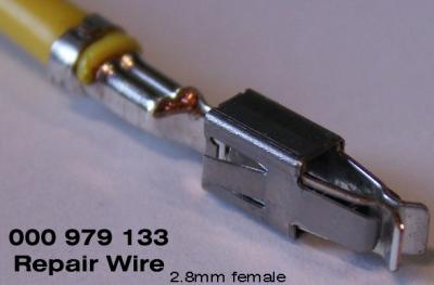

  6. As usual right after I post the question I found the answer on a Audi audio site http://www.nsxjr.com/Audipins.html. The part is N90684405. There are two additional parts that already have a short wire pre-crimped listed as "Repair kits" 000979133 for 1mm wire and 000979225 for 2.5mm wire. The repair kits are stocked by both local VW and Audi dealers but no luck at the local Porsche dealer.

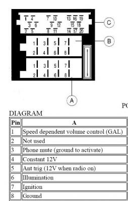

  7. Hello all. I am in the process of adding the Escort 9500ci to my MY06 C2S Cab and want to make use of the mute function. khnitz was kind enough to post a picture of the pin outs of the plug on the rear of the PCM and Loren confirmed A3 is the pin. I would like to connect the 9500ci to A3 to enable the 9500ci to mute the radio upon an alert. I have searched but can not find a part number for the pins to insert into the empty hole in the "A" connector. The "A" connector has several AMP/TYCO numbers 928524-1 as well as a VW/Audi number 357 035 447. Can anyone tell me a part number and/or source for these pins? Thanks in advance for any assistance.
