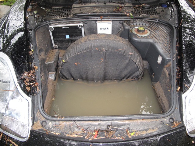

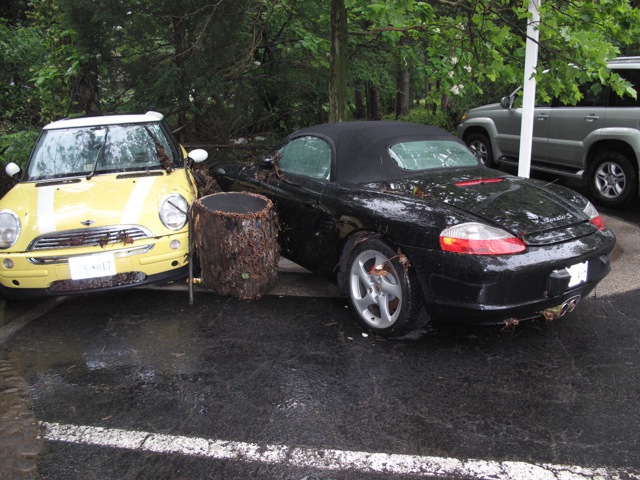

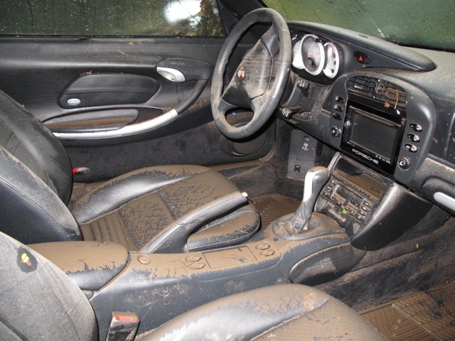

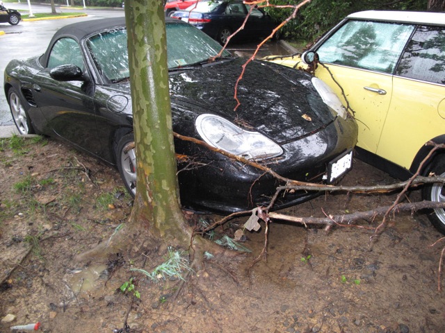

  5. Well, the 986 I bought April 2008 and spent countless hours on installing electronics, mods and paint restoration was totaled in a flash flood 2 weeks ago. This forum was tremendously helpful with all the work I did. I was having a few beers after a softball game at a local sports bar. The folks at the restaurant announced that the back parking lot was filling up fast from an overflowing creek with all the damned rain we've been having in the mid-atlantic region. By the time I got outside there was a river flowing through my car and mini cooper on my fender! I waded out when it was up to my trunk lid to try to rescue my laptop from the trunk... too late. By the time I made it back to higher ground it was over the roof! My insurance company (State Farm) was really good and with the receipts I produced on the work put into the car, they gave me $28K. I really would have preferred to get my car back but such is life. I'm happy to report that I've already found and purchased a 2005 Boxster S with 6,300 miles on it and now begin the process of installing items to make it just right for me again. I thought you might enjoy a few pictures of the mess the flood made of the car. Check out the "expensive German fishbowl" that used to be the front trunk.
