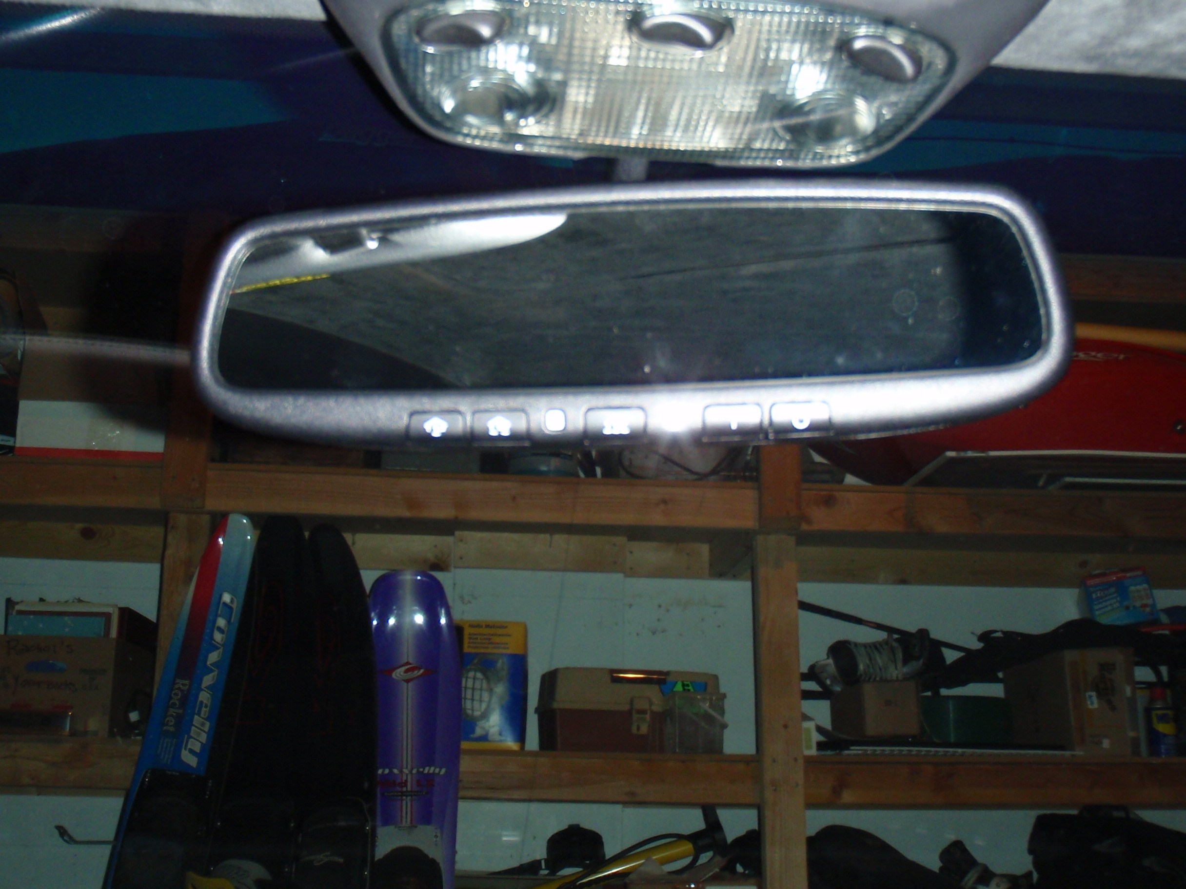

  5. Having just purchased a 2002 996 Turbo I was quite disappointed that it did not have a homelink garage opener setup in it. I researched the internet for awhile and saw that some people had integrated their garage door openers and made a switch with the targa top switch. I didn't like that option very much as you were still using the old remote and if you needed two remotes it would start to get cumbersome. I bought a Gentex mirror on ebay with the homelink option. To get the old mirror off was a lot easier than I thought. I heated up a metal putty knife and slide it between the glass and the mirror. It came off pretty easy. Next after taking apart the old mirror I used my volt meter to find a hot wire, it was already there from the old dimming mirror, it was brown and red on my car, I also picked a wire that was hot only when the key was on. I then grounded to a blue and black wire. That was about it. It took about an hour and now I have homelink opener for my gate and garage. Sorry I didn't take any pictures.
