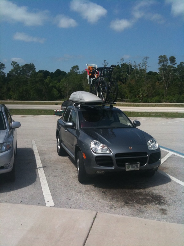

  10. Thanks for everyone above with the towing tips. Ended up renting a 6' by12' trailer from uHaul in NYC. Below is a summary of the trip Made the trip from NYC to Miami in 22 hours. Average speed was 65 mph, average MPG was 9.8. The poor mileage was also due with having two bikes up on the roof as well as a Thule hard over container. The CTT was a champion. They only problem I had was looking in the rear view mirror and seeing a uHaul tailgating me for the entire trip :) Got a speeding ticket at 4:00 AM in the morning in South Caroling on I95 going 86 in a 70. 86 was probably the fastest I was going the entire trip and it happened to be when a South Carolina State Trooper was hitting me with instant on radar (I forget what band it was). The Valentine lit up when I was about 100 yards away from him sitting hidden in the median. the uhaul experience was actually much better than I anticipated. They were very friendly and had decent automation at the two locations that I visited. The trailer was in good shape and the guys were super helpful putting on the trailer (as well as helping ot diagnose a wiring issue)
