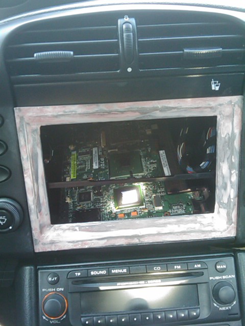

  11. Hey everyone. after about 3 months of waiting for my parts and extensive planning. I've finally semi finished my 1st car pc fabrication. i have my exams these couple of days so i don't really have time to post a step by step diy but here are some pictures, i hope you enjoy. I moved my stock radio to the lower section (had to kind of force it) since i have the MOST fiber optic and switching it out would be too costly and probably way too hard for me to do, so i added an fm modulator in and put it to my asus eee audio jack (btw, i should have mentioned the car pc is made from an asus eee) i then added a touch panel to the asus eee and wired a external power button to it. added an power inverter for the eee power source and fabricated my own bezel. (which actually took wayyyy more time than i thought) Update: Actually, not much to update but i loaded windows media center on my eee and it works pretty well. just a bit annoying since it makes a beep everytime i use the touchscreen (i might be able to shut if off, not sure yet) - as per the sound quality, i can't say it sounds the best, but for me, it certainly is not bad. if you put the volume too loud, it will sound distorted though. (and when you're not playing anything, there will be engine whine) <- if you have the modulator that shuts off when there is no audio input (i've only heard of these and havn't actually seen one), this should not happen. At the end, im just really happy with the result. As it turns out, for whatever reason my picture files are too big so i can't upload some of them...~_~
