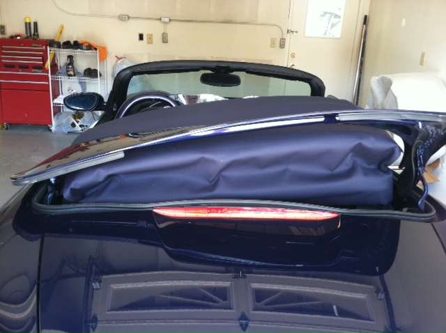

  3. Everything back together and working better than I can ever remember...very smooth...just need to get the dent taken out of my clam shell from the twisting. Costs $168 to replace push rods and cables...beats the $2000 others have been quoted by the dealers. Thanks to everyone for their posts...couldn't have done it without you. Gary
  4. That's unlikely since it is one motor that drives two cables. I just finished taking mine apart and putting back togehter...one of the cables was broken. I offered my phone number if he wants to call me in the last reply. GW
  5. Same thing happened to mine... Here's what to check. More than likely the cables how broken. There are that are driven by one motor. When one cable breaks, the motor carries thus lifting the clam shell on one side and not the other. If you keep trying to open it, there is a red/white plastic ball joint on the end of the arm that connects to the top and that will break stopping everything. There is a way to release the top and do everything manually but you will probably have to get from the drivers/passenger seat and pry off off the spring that is connected to the clamshell. If you want, give me a call 616-304-1951. When this happened to my 01 S it freaked me out....unfortunately my clem shell is bent so I'm hoping to get it straightened out. I purchased the replacement cables and push rods from Sunset Porsche...$140 for everyhing. Gary

  12. After trying to find out what caused the red balljoint to break, I found the square drive broken off in the motor...hoping a replacement cable does the trick. GW
  13. Had the same thing happen to mine. At first I thought it was the red ball joint that had broken which it had but I was more interested in why that happened. Turns out the square drive from the cable to the motor had twisted off suggesting the cable is jammed somewhere along the line. Hoping a cable replacement will fix the problem...parts to be ordered tomorrow. Gary
  14. OK...after dismantling the clamshell so I could see what was going on, the culprit was the red ball joint...as suggested, it had broken on the drivers side....the bad news is I have a twisted clamshell which hopefully a body shop can straighten out....there are no creases just a big bend. I'll order the replacement parts tonight...metal type. Is there a way to check of the motor and transmissions are OK before I put everything back together? Thanks for all the posts...on a side note, I found a pair of Maui Jim sunglasses that I thought were stolen about 8 years ago..they were $275! Gary
  15. You mean the red ones? I popped both of them off so I could release the top but the clamshell is still stuck half way up on one side and almost closed on the other....see picture. How can I release the clamshell please? Thanks Gary
