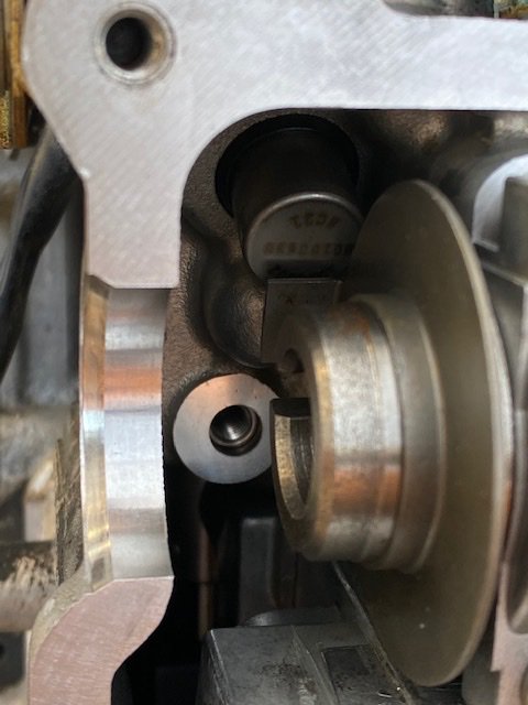

  7. Thanks for the responses I figured that was the case with the oil! This is a replacement used I picked about a month ago so don’t know the history on it. I ended up getting some bottle of liquid moly so will use that for now. I’ll pick up some driven on the next round. Regarding the variocam pads both sides are done and have been properly timed. Wasn’t as hard as I made it to be. Bank 1 is sealed just need to seal up Bank 2. Did have a question does Bank 2 have this small heat shield like Bank 1? I didn’t see it and saw there is a small screw hole for something was just curious if it was missing it. Porsche Cylinder Head Heat Shield Genuine Porsche 99610423301 996.104.233.01 996 104 233 01 996-104-233-01 | Pelican Parts WWW.PELICANPARTS.COM Genuine Porsche Cylinder Head Heat Shield $4.00. Call (310)626-8765. May Qualify For FREE SHIPPING. Parts# 996 104 233 01 996-104-233-01... Attached a picture of the screw hole in question.

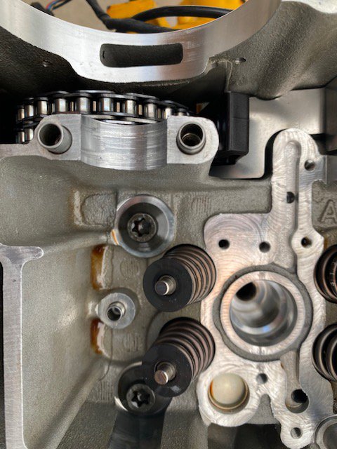

  8. I was going to use some fine sand paper but had a feeling that would be bad. So wanted to post it on here. I had a feeling that was the case. If I was to put in another set of cams it would probably mess those cams up. I guess i got no choice but to put these back in as is. How long do you think this motor will last with that scoring? How does that happen? To long of an oil change interval?
  9. So I was looking at my camshaft and cylinder head and it appears to have some pretty bad scoring on them. attached pictures is there a way to clean these up? Or am I just putting them back in as is? Unfortunately?!?
