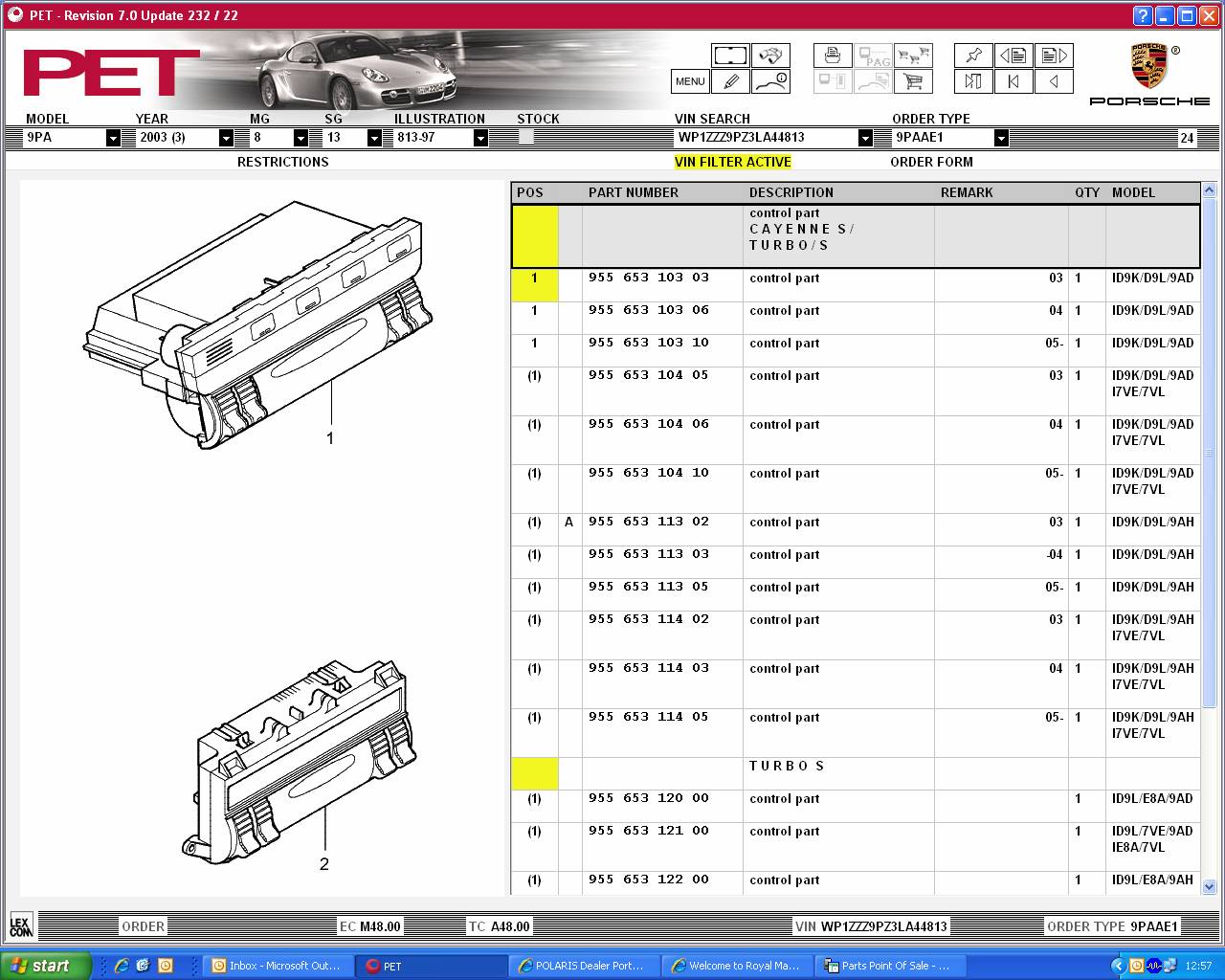

  5. Thanks for your reply Loren. I don't mean to sound stupid, but how can I find out which model mine is in that code? The Porsche dealer has typed in 9PA as the model.....but where did he get that from? Also 9PA doesn't match any model listing in the column.....its confusing. Can I tell from my VIN the model or do I have to look elsewhere to find which part. I know its one of the 03 parts..... Thanks in advance again Loren. G
  6. Ok, I will try the picture thing now..... There we go hope that works. Is there any possible way of finding out if the controller is actually the problem?
  7. Thanks for the reply Loren. The wreckers yard could only get me the VIN off the vehicle its coming off. When I spoke to Porsche they sent me the diagram via e-mail to choose which one my AC Controller looks like. Part #955.653.103.03 I know its the one in diagram one but I need to know which one the wrecker has as well. I am so confused!!! **** Porsche!!! Thanks for your help Loren Sorry no idea how to get the pic on here
