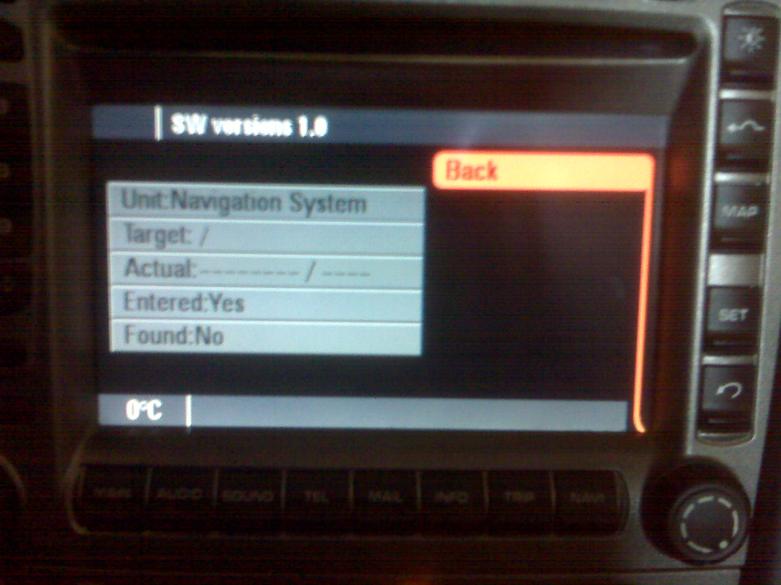

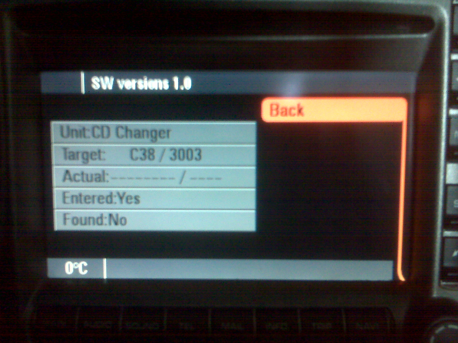

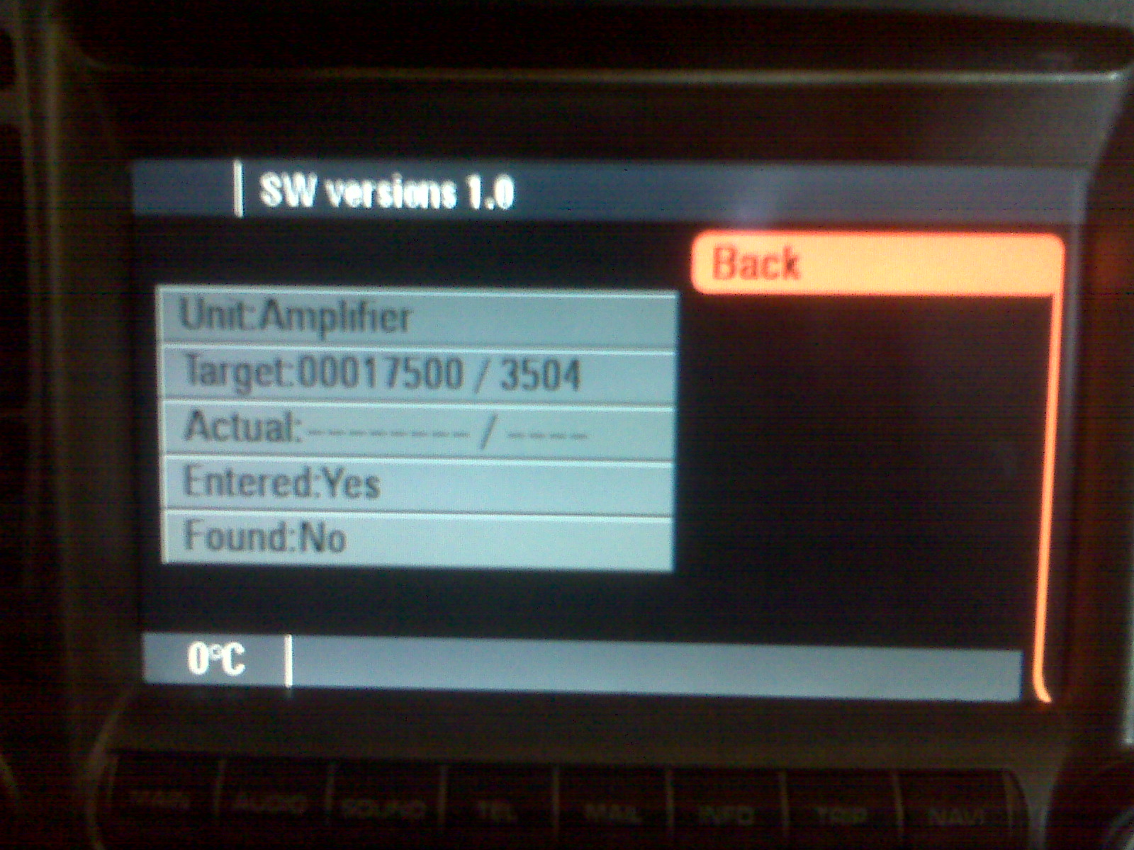

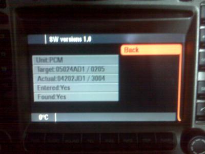

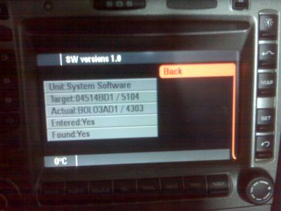

  2. Thanks for the help AP997s. I noted you are in a similar situation, and I am hoping that you are able to straighten out your PCM in as low cost a manner as possible. The screenshots are indeed after, not before. I think I might face a little warranty difficulty since the CD that is stuck in the drive is labeled (in marker no less) "PCM 2.1 update". My plan right now is to play dumb with the dealer and tell them I found the disk in the glovebox and stuck it in. Will update as to the effectiveness of this strategy!
  3. Hello all, First of all, to echo another poster, BEWARE trying to update your PCM yourself, you can create a mess. That said, I have a mid 2005 US 997 carrera S cabrio with navi and bose that I recently purchased used from a dealer in AZ. This car is still under factory warranty. I tried yesterday to update my PCM 2.1 with the the Porsche MMI update CDs (1&2) that I downloaded from the internet along with an updated navigation DVD (997.642.257.05) that I ebayed. I did for two reasons, 1, to enable MP3 playback in the CD unit, 2, to get the latest maps and POI. I inserted the MMI updated CD1 into the CD drive (not the changer or DVD navi unit) and started the process. After a few minutes the system appeared locked up while checking the disk and so I stupidly hit the eject button. This was a huge mistake. The system ejected the CD and then did not return to the main screen, I did not take notes on what exactly was on the screen, however it seemed that the status said OK, so I assumed this was not an issue. I reinserted the CD thinking perhaps it would pick up where it left off (by this time I assumed it was still working and not in fact locked up). The system did not move further. I turned the car on and off and attempted to eject the CD, no luck. Now, the system gives me a message after a few moments (most likely after scanning the MOST ring) telling me the amp, CD changer and AMP are not available. I have tried to push 148, I removed the fuse and replaced after a few minutes, however I still cannot get the CD to eject. Based on the screenshots I took of the system post update (attached) and a lot of research that I should have done before this and not after, I surmise that I was at Level A and had I permitted the update to proceed would have been updated to level B. My question to this list is whether there is anything I can do at home, or whether this is going to have to go to the dealer at this time. I am hoping that I have not bricked my entire PCM system. Being a techno-geek, I assumed updating a Porsche would be as trouble free as patching some software on a phone or a PC, I was very wrong. Thanks and really enjoy this board! - nick in sf
