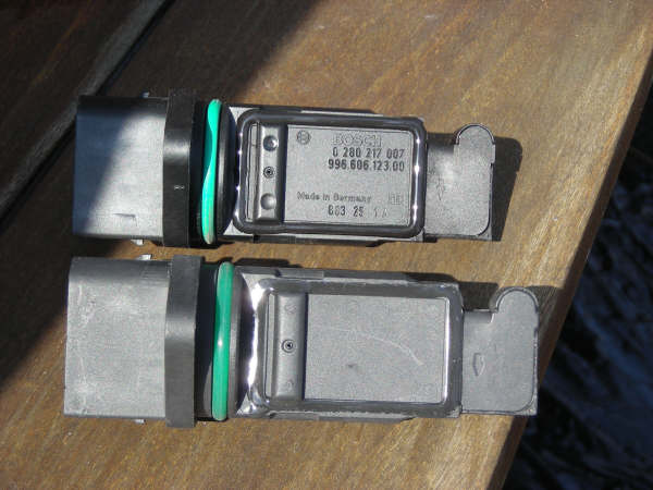

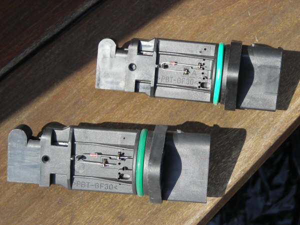

Update, and a test that might prove useful to anyone considering an aftermarket MAF sensor.
On Friday the aftermarket MAF sensor arrived from MaxSpeed motorsports, mentioned above. I attach a couple photos comparing the original MAFS and the aftermarket one. They are identical except for the part numbers missing from the aftermarket MAF sensor, no doubt for infringement concerns. And the green O-ring is a bit darker.
Installed the aftermarket sensor, and then disconnected the battery for five minutes. I then drove the car agggressively on a nearby fun-run, up Rt. 22 alongside Kenisco reservoir. Stopped for lunch, and then, after only 10 miles, the dreaded CEL came on. Sad, but didn't let it spoil our first top-down run the first really nice day this year!
Next test. I located some properly colored blue/white wire from an old car radio. Soldered it crudely onto what was left of the wire for contact no. 5 on the wiring harness [see first photo in post #1 above], then stripped back enough factory electrical tape to connect to the other end of the original wire. Put on some baby blue heat shrink tubing. See photo.
No CEL until about 65 miles -- then it came on. Then, at about 150 miles, CEL went off. I checked, and the solder appears to be holding on the wiring harness. Will update this post as we go along, so it might provide a semi-scientific test of a relatively inexpensive MAF sensor.

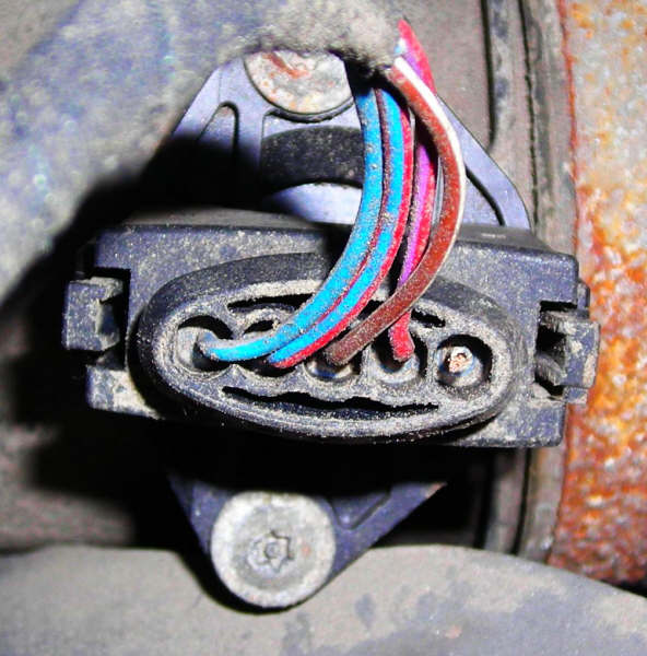

Background. My car is a base, 1998 2.5 5-speed with 87k; I'm the third owner. Last week, my check engine light [CEL] came on. I had driven the car about 3,000 miles with no CEL prior to this. The car has been running and performing great, feeling like the full 200 hp and getting about 22 city and 30 highway mpg.
My nearby Porsche shop was kind enough to quickly hook up their analysis computer, and inform me that the CEL activation was caused by the Mass Air Flow Sensor [MAF]. They did not provide me with the code that led to this conclusion.
Following the advice of the always-helpful Renntech.org, and the Mike Focke treatise on the subject, I was able to remove my MAF sensor, spray it with MAF sensor cleaner, and re-install it. It had looked like new, and was not at all dirty. I made the CEL go off, as instructed, by disconnecting the battery for 30 seconds. But after a few miles, the CEL came back on. It seems to be running same as before.
I decided to order an aftermarket MAF sensor from Maxspeed, a company in upstate NY with a good feedback record on ebay [$137 shipped]. I am hoping this will bring me back to CEL-off, but have some fear that the problem is elsewhere. But in the course of opening, inspecting and wiping dirt off the engine, I found these three mysterious items that didn't look right. I went through the service manual regarding all three but could not find them there.
Mystery 1. When I went to disconnect the MAF sensor's wiring harness, I noticed that one of the five wires in the harness had been snipped completely off, with only about 1mm left inside the harness! See photo . There is no other trace of this wire remaining. Of all these mysteries, this one is the most troubling ... partially disabling the MAF sensor to allow more toxins into my catalytic converter?? Can anyone guess why this was done, and what effect it might have on the car's performance?

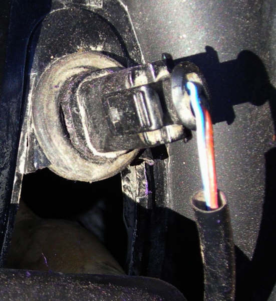

Mystery 2. The next photos show a hose to nowhere, near the cap for power steering fluid. Something's not right. What is it for? Where does it belong? Is it meant to dangle? Is it a vent for the power steering fluid reservoir?
Mystery 3. While cleaning off the engine, the electronic object in the next photo came loose. It snapped back into place on the passenger-side intake plenum, but the underside appears otherwise not to be connected to anything. What is this thing for? Is it a thermometer?
