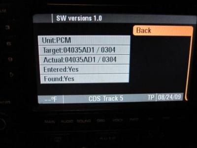

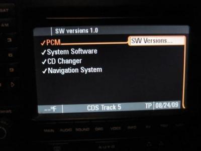

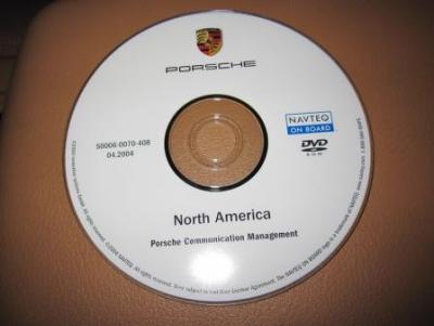

  8. Thanks for your post... I did the Main and Trip button and it shows SW Version 1.0. Does this mean I have PCM ver. 1.0. My PCM comes with a DVD NAV. I am attaching some pictures of my PCM for ref.
  9. I am trying to find out which PCM version do I have. I bought a 2005 Cayenne that came with NAV but doesn't have reverse camera. Does anyone have any ideas how to install a reverse camera on the factory PCM. I am thinking to buy a Multimedia Video Interface (from http://www.xcarlink.co.uk/bmy_search.php?b...e&Year=2005 ) that is why I need to know the version of my car PCM. Does anyone have any comments or suggestion? Thank you Ken
