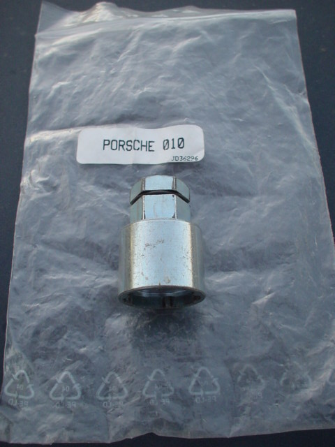

  1. One of the 30 should be a match if you have the original locking bolts. Too bad you did not have your car there to try and match it that way. Take a look at your option sticker and see if the code is written there. When a new car is prepped some mechanics write the code on the sticker so when it is later service and a wheel needs to be removed they can get it from the master set. The key originally came in a plastic bag with the code on a sticker. Good luck trying to find it on an 8 year old car. Can't get the code from the VIN. Maybe have it welded back together?

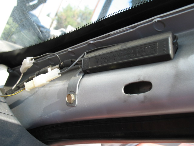

  2. You might also check to see if the emergency release cable is routed to the correct location. In this picture it is not....

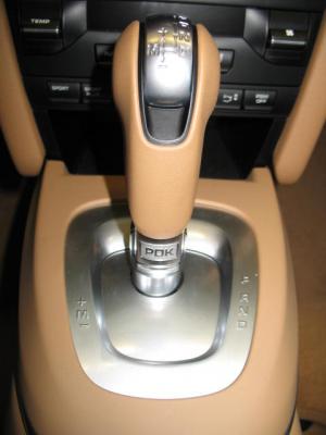

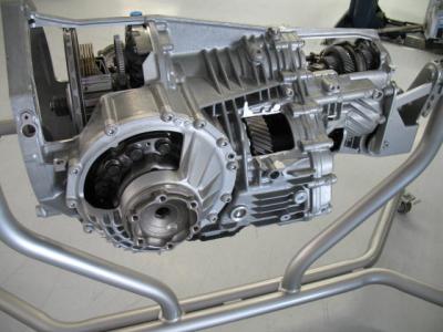

  6. For historical value I took the next 2 pictures 6 years ago when the 996 flavor GT2 first came out. Such a deal. A few more than 169 units were built - or so we were told back then. Last 2 pictures where taken today of a cutaway PDK transmission. I think it will leak oil....

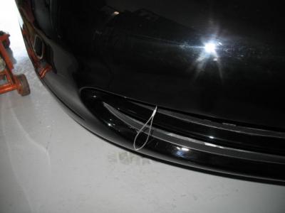

  9. Porsche uses shoelaces to hold the car together....

  13. Old news, but my local dealer has 2 of what I guess are the launch cars, with the PDK transmission.

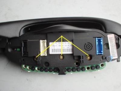

  17. This is being made way to complicated for the LED disply bulbs. Part number is 999 631 303 90 and they are 1.5 watts. There are 3 bulbs for each LED, and I have 3 yellow lines going to them. They are on the back of the cluster and the cluster does not need to be opened up to replace them. There is a row of 1.2 watt bulbs in black holders on the outside of the cluster, but they are for the idiot lights. There are also bulbs inside the cluster, but they have nothing to do with the LEDs.
  18. 1997-2000 used bulbs. 2001-2004 used leds. You service guy may not be up on the old cars. Hitting the top of the instrument cluster sometimes makes it work if the bulbi is not burned out. You can clean the contacts for the bulb, but since you have to remove the cluster to do this you might as well replace them at he same time. The replacement bulbs come in the plastic holder and the holder is tan.
  19. Each of th 3 LCDs has its own bulb.

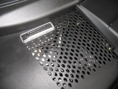

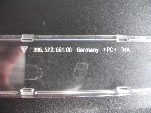

  23. There is a ball bearing on the back of the engine case. The bearing fails and the shaft is no longer supported. First pic is a 1999 996 C2 with an intact bearing and no problem, and the second is a 2003 Boxster 2.7 with a failed bearing. The balls were literally falling out of the bearing. This is why the first place to look is in the oil filter - to see if metal silver bits from a failed bearing have been trapped by the filter
