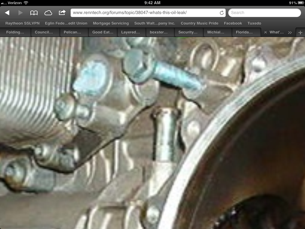

  1. Road tested my Boxster yesterday after re-installing it's rebuilt Tiptronic and found a differential fluid leak. It seems to be at the breather tube. The tube does have a blue fluid all over it so I am sure it is coming out of the diff and not the Tiptronic. Could this be caused by an over filled differential?

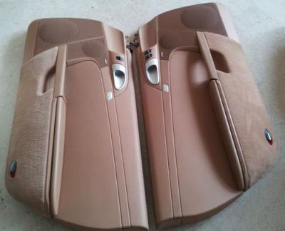

  12. I need to replace the leather door panels on my 986 Boxster, but could only find a set from a 987. Does anyone know if they will fit? I know that people have replaced the doors on a 986 with a 987, but not just the panel. Thanks MJM
