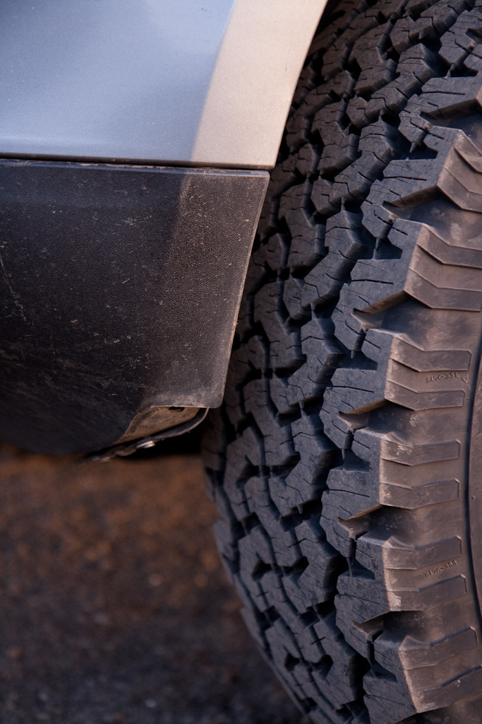

  4. Sorry for the late reply guys. I snapped some pictures last weekend while fishing. In the second picture you can see the front wheel arch, where I removed the mud flap and bent the plastic from the wheel arch over where the mud flap was fastened. This is basically plastic to plastic with screws, but it holds pretty well. It doesn't look pretty up close, but you never notice it. I had the BF Goodrich 265/65R18 tires microcut (as can be seen on the close up image) to be able to use them in the snow. Road noise has not increased noticeably. The car handles a bit differently, much better on gravel and only slightly worse on asphalt. I recommend the change to those that want to use the Cayenne off-road or on rough roads. Thor
