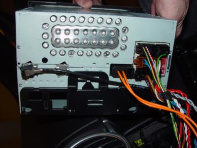

  10. Wire colors are not unique to specific functions (in 99.9 % of the cases) - so do not bet on that specific wire. Find switch with illumination and tell me the wire colors and I will look them up - but I can't look up all the grey/red wires in the car. How about this? There should be a MOST fiber optic connector, and then 3 regular connectors (with copper wires) that plugs into the back of the PCM 2.1 head unit. Attached is a photo of the connectors. I'm assuming that one of the copper leads is in fact an illumination wire, but I have no way to tell. If you can find the pin-outs for these 3 connector, or just the one that is illumination, I'd appreciate it. Thanks, Bryan Sorry, none are an illumination wire. From looking at the schematic it would appear that the PCM unit get a network signal over the CAN bus to turn on it's own internal illumination. Hmm...nothing easy, huh? How about running a tap from the illumination switch? Would that be fairly easy to get at from underneath? Thoughts? BN
  11. Wire colors are not unique to specific functions (in 99.9 % of the cases) - so do not bet on that specific wire. Find switch with illumination and tell me the wire colors and I will look them up - but I can't look up all the grey/red wires in the car. How about this? There should be a MOST fiber optic connector, and then 3 regular connectors (with copper wires) that plugs into the back of the PCM 2.1 head unit. Attached is a photo of the connectors. I'm assuming that one of the copper leads is in fact an illumination wire, but I have no way to tell. If you can find the pin-outs for these 3 connector, or just the one that is illumination, I'd appreciate it. Thanks, Bryan
  12. So, would that still be a Grey/Red wire somewhere on the existing radio connection? I have PCM 2.1, with BOSE & Nav currently. Thanks, Bryan
